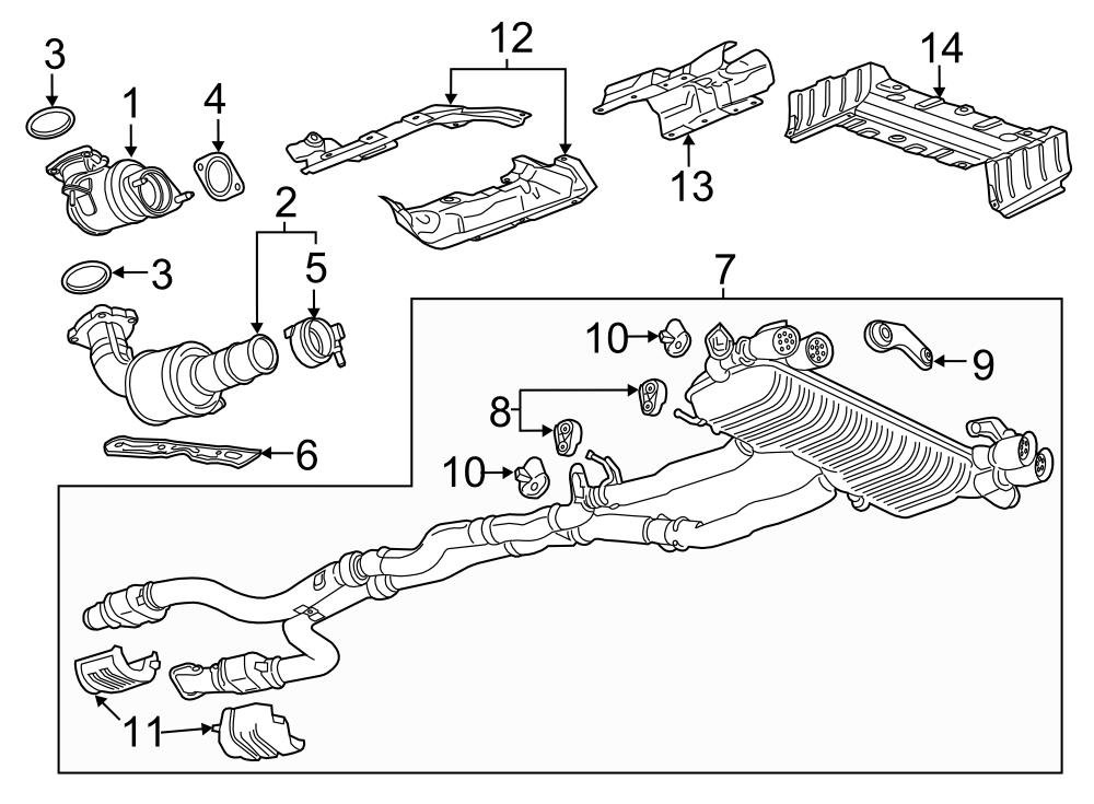

The NPP valves and the AFM valves utilize the same actuator (item 10) and are no longer available separately. But, some dealerships may still have the part on the shelf prior to the exhaust drawing engineering change. Try this parts lookup website: http://oemcats.com/oem-parts/84560761.html and you might find the part you need.
Actuator - 84560761 (last update)
Supersession(s): 22839592; 84362456
MSRP: $486.51
List Price: $204.44
