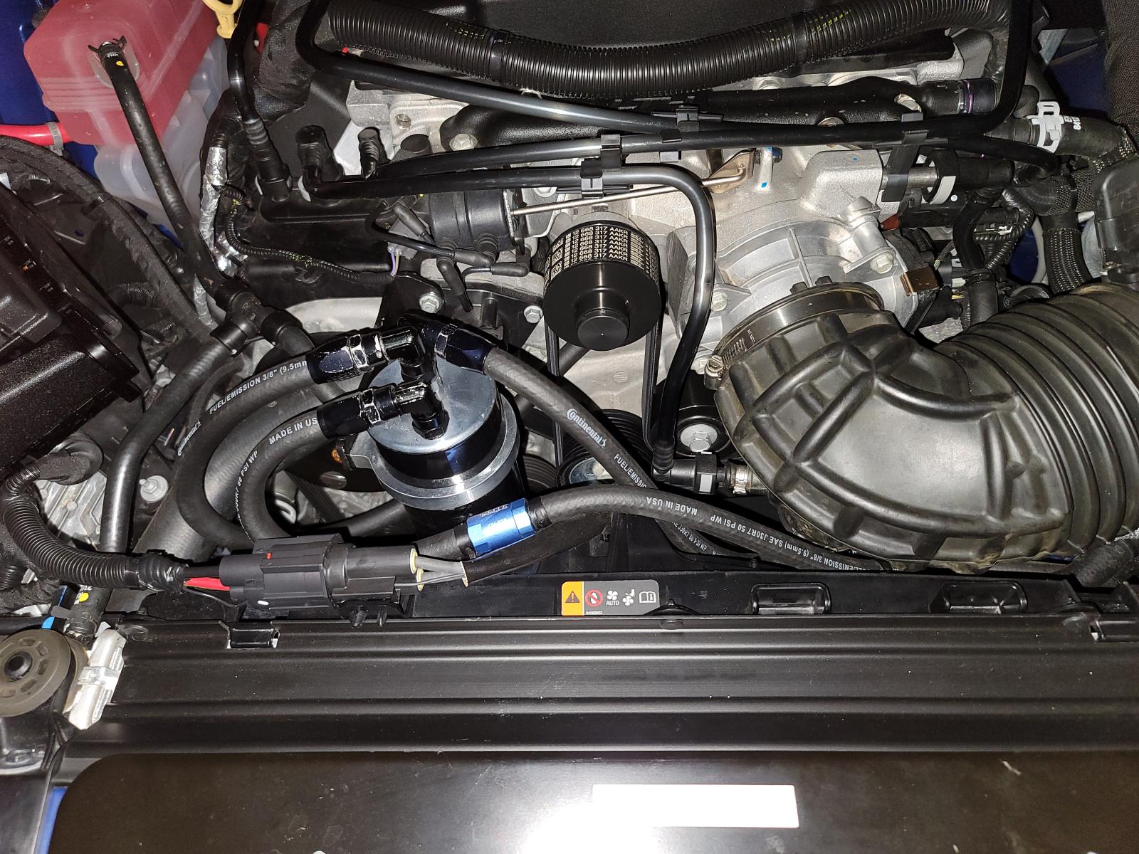

That's the great thing about front mounting the can, I reduced the hose length to about 18 inches at most (ADM coolant reservoir is where the can used to sit)
ZX-10R is offline   Reply With Quote
Looks good and I'm glad you used the high flow valves Not sure if you saw my vid on them, but they really do allow a lot more flow.

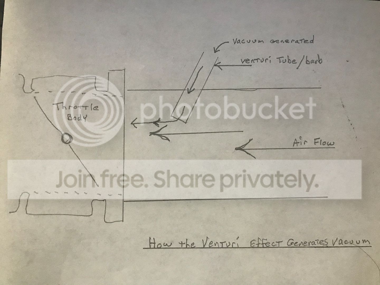

Originally Posted by Bangkok
I just like the thought of having the system open up when my foot is on it, which I tend to do a lot.
Vented catch cans are not more efficient at full throttle if that's what you're implying. Higher velocity through the can means LESS oil is trapped and the big lines MM owners crow about mean nothing. You would need a much larger can and MM volume isn't much different. Again, clearance in the engine bay is the limitation
https://www.eng-tips.com/faqs.cfm?fid=1153
