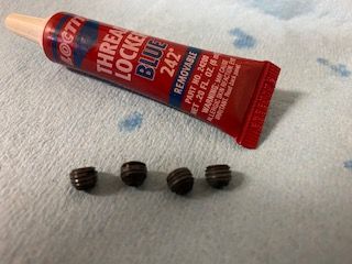

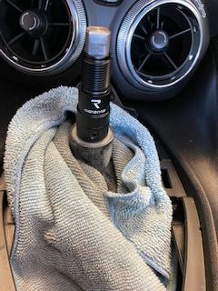

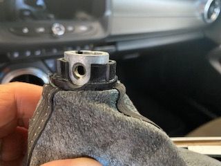

Here's the info on the pics in the order they appear:

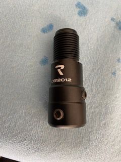

1. Adapter
2. Set screws and Blue Loctite

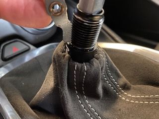

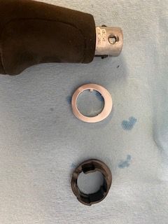

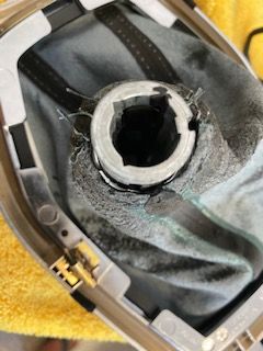

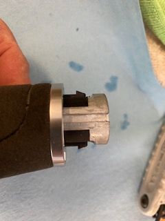

3. OEM knob removed showing locking ring
4. OEM locking ring unlocked and ready to remove
5. OEM knob with locking ring removed
6. OEM knob showing what's locking the ring on the knob
7. OEM knob parts removed - Locking ring, collar and knob

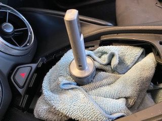

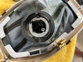

8. OEM knob remove from shifter - micro towel is there to prevent parts from falling into the black hole!

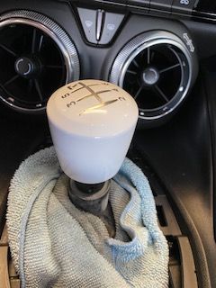

9. Raceseng Adapter installed
10. Raceseng Adapter and OEM Boot installed
11. Raceseng knob orientation process

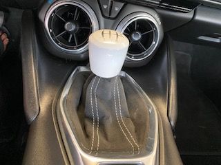

12. Raceseng knob installed

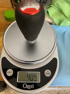

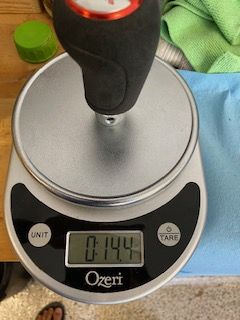

13. OEM knob in gram weight

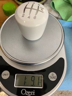

14. OEM knob in OZ weight

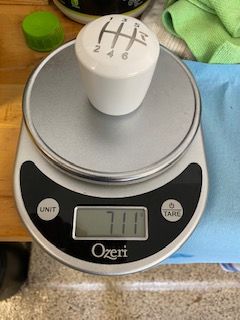

15. Raceseng knob in gram weight
16. Raceseng knob in lb/oz weight
17. Scale info...just thought I'd add this...the wifes cooking scale
18. Finale Outcome! (almost forgot this pic!)

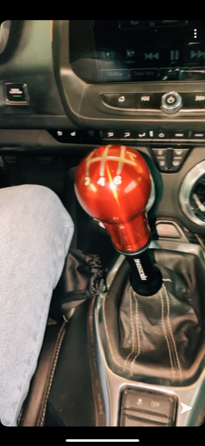

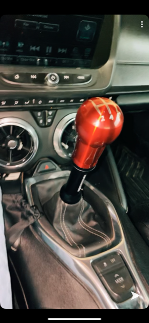

I love your write up on Raceseng's weighted shifters, it was reading this thread that got me to go ahead and pull the trigger on one for my car, I was heavily debating between the Ashiko and Prolix, since those are the heavier ones they offer, I wanted the Ashiko for being the heaviest but I didn't want my snifter sitting shorter than stock, I like having my travel distance from steering wheel to shifter shorter than having the feeling of a shorter throw at the expense of reaching farther for my shifter...
So i went with the Prolix in Red Translucent, should be arriving via UPS today, I'm excited to give it a go I can't stand the notchiness from first to second gear, so I look forward to that being diminished.
EDIT:
I AM IN LOVE! The red translucent finish is beautiful, i cant wait to install it soon as i'm off work
EDIT:

The Good: Everything lol, it was easy enough to install, and I immediately noticed a difference in feel when sliding from gear to gear, it reduced some of the notchiness, and makes shifting feel much smoother and just overall more enjoyable and satisfying-feeling, I think this combined with a short throw shifter would be amazing, but that's in the future...
The Bad: I had to think about this one... I honestly can't think of any that I would call "bad"... The shifter is metal, so on hot days, you'll definitely want to remember to use the included pouch to cover the knob or else your hand is gonna get scorched lol ask me how I learned that lesson... so I guess the bad thing is dealing with that, but as for having a weighted shifter, I don't see any bad to it, I have no desire to go back to stock.
The Ugly: The engraved shift pattern which is optional, you can have it without, I chose with it, and think it would be nice if the engraved pattern could be filled in with some black epoxy maybe to give it a clean finished look instead.
I have since added the Raceseng shift knob extender because as a former truck driver, I miss the feel of having a tall shifter and with a long throw which I know I know that won't help me win any fast shift races lol but I don't care, I like having less travel from steering wheel to shifter, I can comfortably shift without reaching as far down for my shifter which is a big plus for comfort, and switching back to stock height is just a simple screw and unscrew away I'm overall happy with my Raceseng goodies, while a bit pricy, you do get a quality fitting shift knob and the added weight feels awesome.
