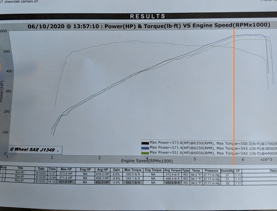

I have found that the car is still pulling hard in the high 5s so I shift right under 6k. Looking at my car's dyno chart the HP levels off at about 5900 and that is where the torque curve begins to dip down. See image below with the orange line. I'm no racing expert but I think that shifting above 6k probably is too late and below 5.6k is too early for optimal acceleration times. Note: This is on 91 octane pump and only a Soler Performance TB mod.

I haven’t run the numbers to calculate the optimal shift point, but torque to the wheels is still probably higher running to 6500 in the lower gear vs short shifting, even with the high rpm drop off.
