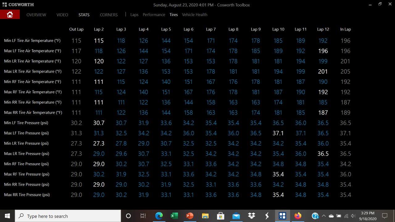

Great. AR1 seem to be more popular outside the US. They do seem very sensitive to pressure at least in feel and feedback. Curious as to what you find as ideal pressure. Data below still suggests 35/36 target hot this point.
The pic below shows the telemetry with AR1 fronts and G3R rears. Lap 3 was quickest pace due to traffic but tire didn't feel totally inspiring and temps and pressure would also indicate peak grip was not yet available. Also would indicate high tire temps @ 37 psi potentially moving beyond peak grip.... think very difficult for a daily driver to get this kind of heat into a tire to experience true grip.
