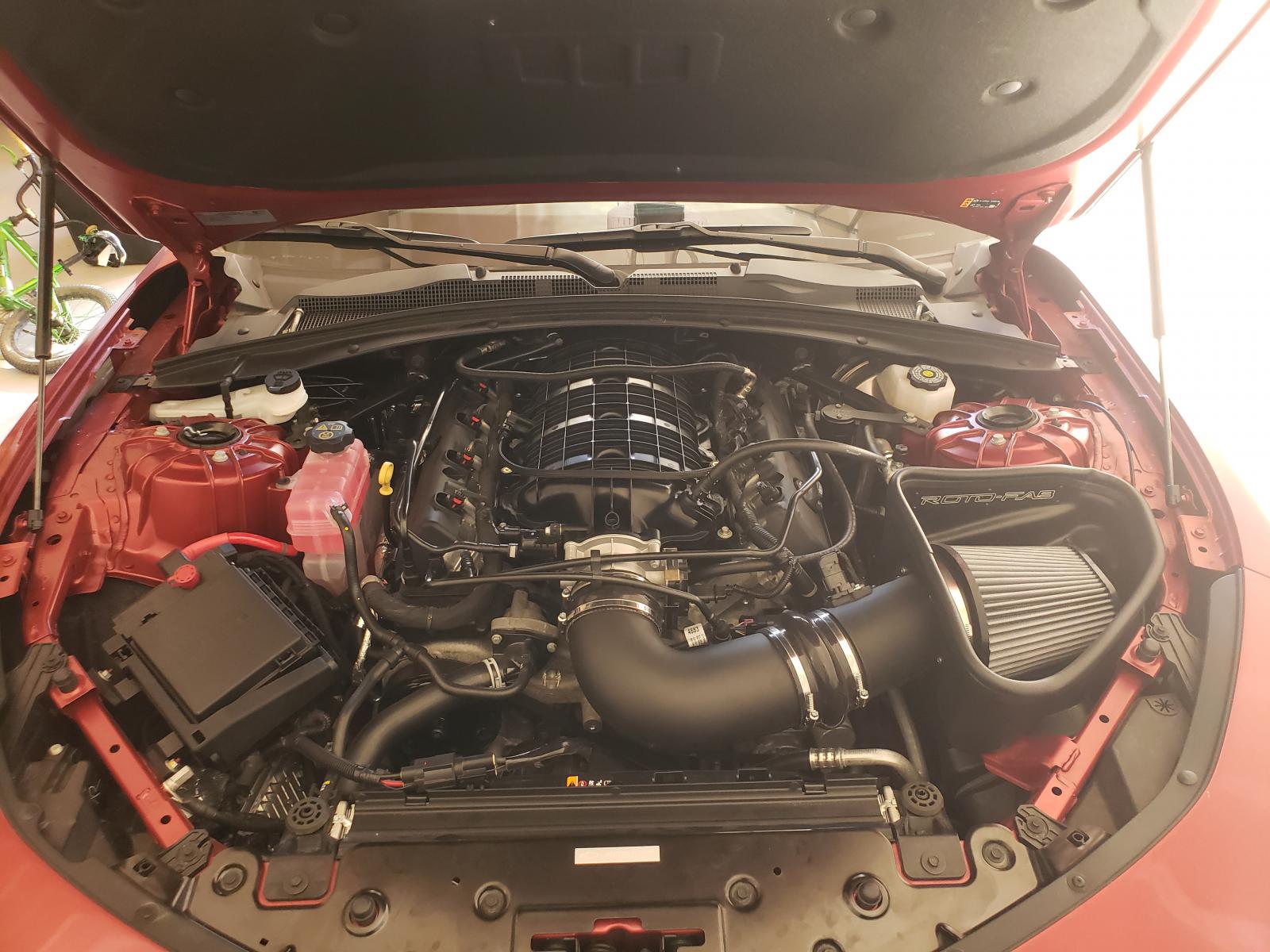

Only took me about two hours for the intake and catch can install. Suoer easy!!

did you put some heat shielding back on? i'm assuming the stock heat blocking rubber had to be removed.

I did not. I didn't feel it was seated correctly with it so I left it off. Talked with another person who left theirs on with the LT2 because he called GPI and they recommended leaving it on. At this point I don't feel like removing the intake to try and make it fit.

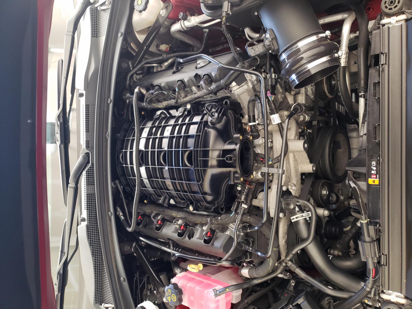

The answer is yes and no. It will fit but I had to trim some ribs off the top to give some clearness under the stb.
