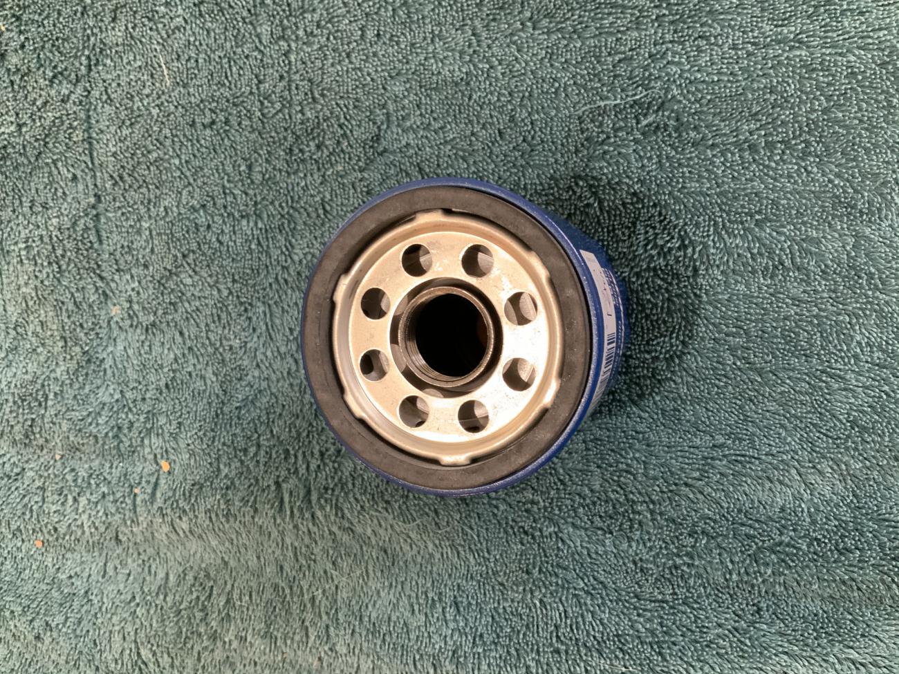

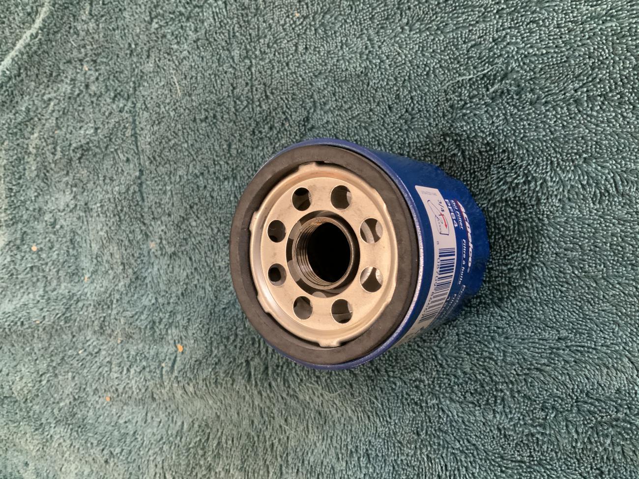

I’m a little OCD about oil changes. LOL. But should the AC Delco PF64 filter have a black seal under the holes? My Ford and Mopar filters do have that seal. I Just wanted to make sure.

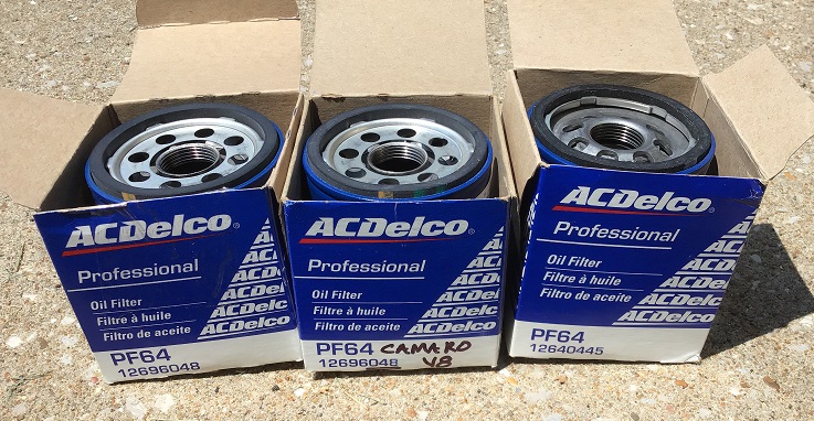

The previous version was 12640445 and it had the ring. The new version is 12696048 and it does not. They changed the design several years ago so you aren't likely to find the "445" version in a store.

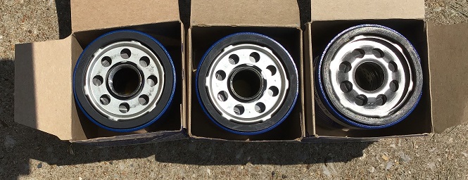

I went around to a bunch of local Walmarts and bought all 6 that I found.

Yee haw! While vacationing in the North Georgia mountains with my older son, I have been checking Walmarts and got lucky at one.

There have been threads where they have been cut open and the differences were shown. You can tell they are made cheaper looking at the top side. I also heard the filter media isnt quite as good on the new one. So I found a bought a bunch of the old ones just for the heck of it. Kind of like a stupid grown man treasure hunt.
