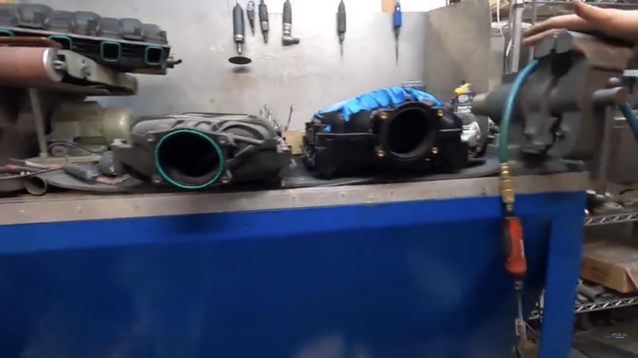

Pick this up at 6:27. You guys catch this video yet?
https://m.youtube.com/watch?feature=...&v=t_ACDsHuZ7M

Originally Posted by cmitchell17 View Post
So people are using the LT2 manifold? I thought there were reports of it not fitting or working?
I don't think it will fit, it sits backwards on the C8 so I'm sure there is going to be at the very least HPFP issues. I don't think it is insurmountable. Bet the C8 manifold is not that expensive. Please let me know if anybody wants to buy one and send it to me, heck I'll even port it and see if it fits before I send it back to you.
hadn't seen that, thx for the heads up. it looks like it would be close, my only concern is fuel. i know of a local guy with a c8 who is planning on doing a stroker very soon. i'm trying to get a hold of the factory cyl heads. get some real info on them. i wonder if he'd let me borrow the intake manifold for a day...?
I'm not sure the MSD could be good enough over the stock manifold or gain enough power to justify its ridiculous price tag over $1200.
The LT2 IM physically fits but can't confirm if it clears the hood or not. You would need to tap for the brake booster fitting in the back and harness extensions for the MAP sensor. I was told the new IM is only $190 so if you are savvy with modifying stuff, it would be the equivalent to a poor mans MSD.
They really could’ve done us all a service and mocked it up on a c7 and ca6 so we have some really beneficial info.
