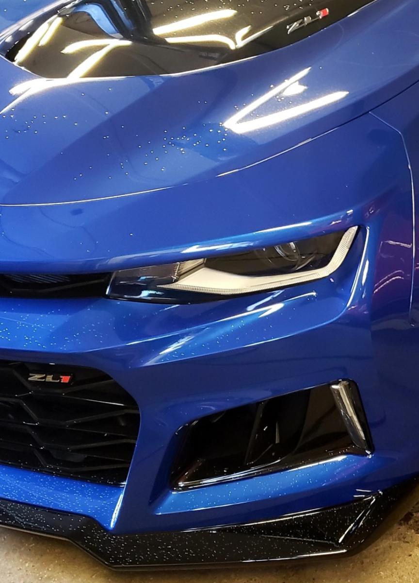

Easy to check, if you see metallic flakes in the black like on the photo below, it's WA 384A (metallic black), if not, it's WA 8555 (plain black).
The descriptive names for these colors are specific to models, you'll see things like "black meet kettle", "stellar black metallic", "mosaic black metallic" all denoting the same color. Heck, my Camaro's red color (WA 132X or G7E) is called "garnet red tintcoat", "caught red handed", "red obsession" and who knows what else.

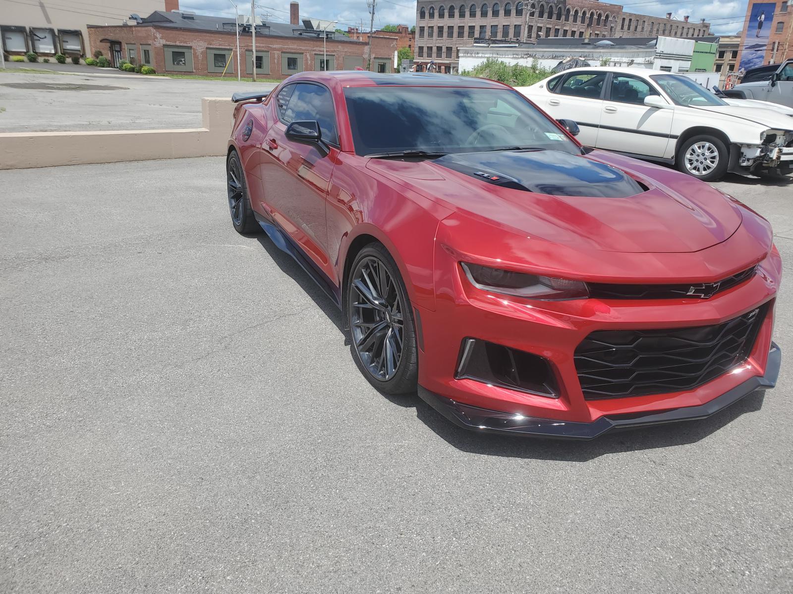

It is mosaic black but there are a few different variations of that available you will have to compare it to what you have. Just had my spoiler and mirrors painted to match. Name:  20200530_122754.jpg

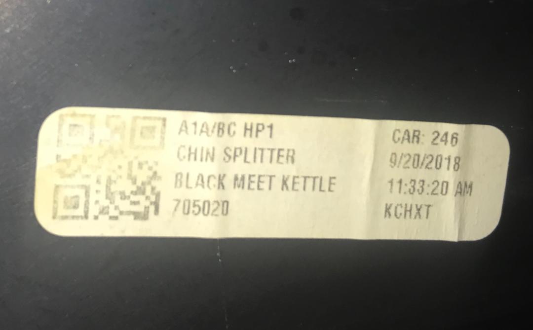

The sticker on the back of my 2019 front splitter
