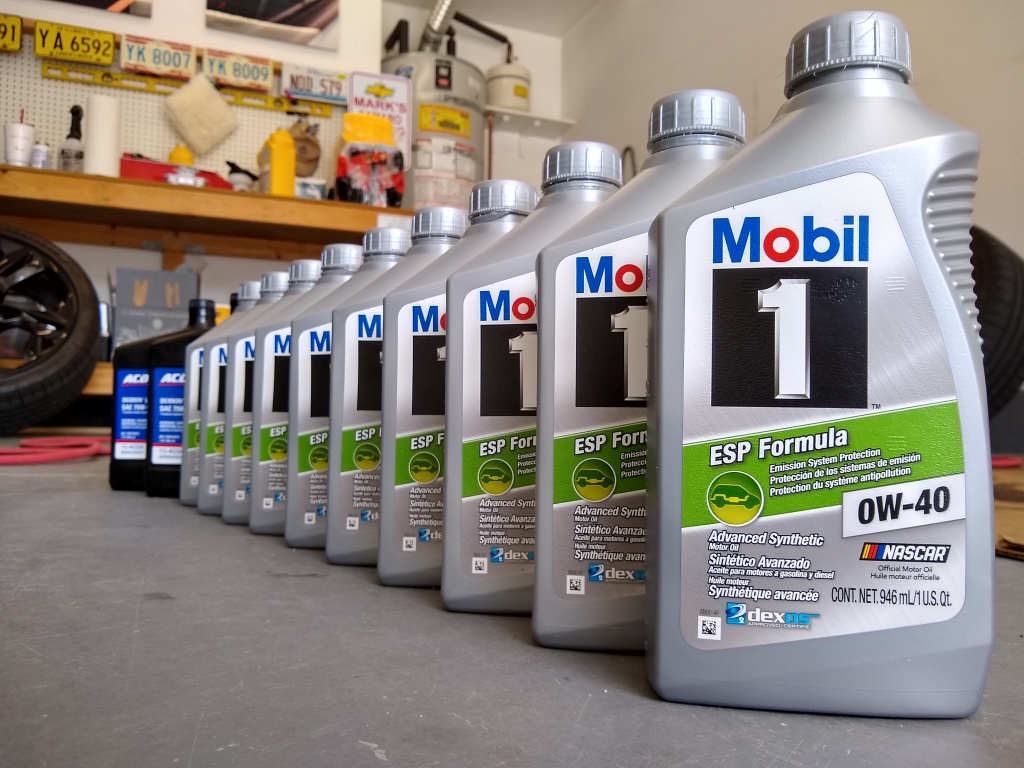

This is the oil you should be using, the filter is an ACDelco PF64:

So dealer just called me back and apologized that they give me the wrong information. They said the parts guy give the service writer the wrong oil specs. But they are changing the oil with 0w-40 dexos2.
