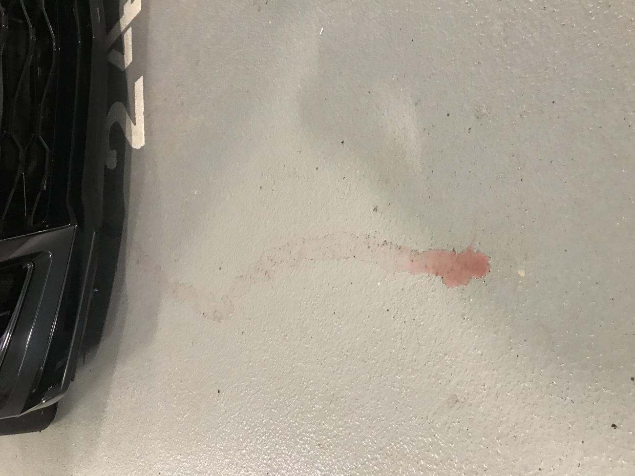

This is a picture of the coolant leak I found twice a few weeks back, but have not seen since.
It was dripping down the passenger side of the front most radiator that is most visible from the large front grill which I now understand to be the primary intercooler (I thought it was the radiator). Thanks for all the advice guys, I'd say it's quite obvious now that you are right.
I had this same power loss problem last track day in June but not as bad, the car was consistently under powered but it never seemed to get worse through the track session like it did this time where it got very severe. I initially thought it was the differential because after the track day I noticed the tire shop had put mistakenly put a 305/30 on the drivers side rear and a 285/30 on the passenger's side rear which is a 2.5" difference in circumference.

I used the ADM reservoir:
https://c-8parts.com/products/2016-2...sivoir-upgrade
I've had no issue with the system coming loose (sounds like a nylock would fix that). It is at a higher position than the Cordes system so a bit easier to refill, but likely not an issue either way.
The supercharger has two 'radiators'. One on the DRIVER's side and one dead center of the car's grill.
The radiator on the PASSENGER's side is an actual engine cooling auxiliary radiator.
Likely the leak could be coming from either and still be in vicinity of that spot. But since you have a power loss - it is more likely coming from the center supercharger radiator (heat exchanger)...needs fixed of course. No leaks are allowed...especially on the road course - slippery stuff!
Do a search on this forum if you want more info - good luck!

It only leaked twice (That I saw, as per the picture I posted) and I’ve never seen it since then, my mechanic couldn’t find a leak either which is why we ordered the adapter to do a pressure test.

Also I’m guessing depending on where the leak is I may not have to replace the entire intercooler, but just a part of it?
