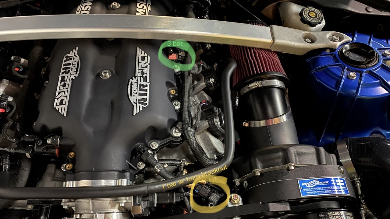

I bought the DSXTuning Baro / IAT and I’m trying to figure out where to install the IAT Sensor. Is there a location for it or do I need to make a hole for it?

Maybe this can help

Kind of depends on what you are trying to measure with the new IAT sensor.
I am using one, and since I am using meth injection it is setup behind the throttle body in the intake to read the air temp after the meth is mixed with the air.
I just drilled and tapped my plastic intake for the thread on the temp sensor, sealed with 297 Loctite thread sealer and it was done.

Same thing I’m going after. Tuner I’m working with said he wants to measure Meth IAT Temps so I’m going to go into the intake right behind the throttle body. Do you happen to recall what size tap you used?

M14x1.5

Thread helped. Installed with ease! Appreciated
