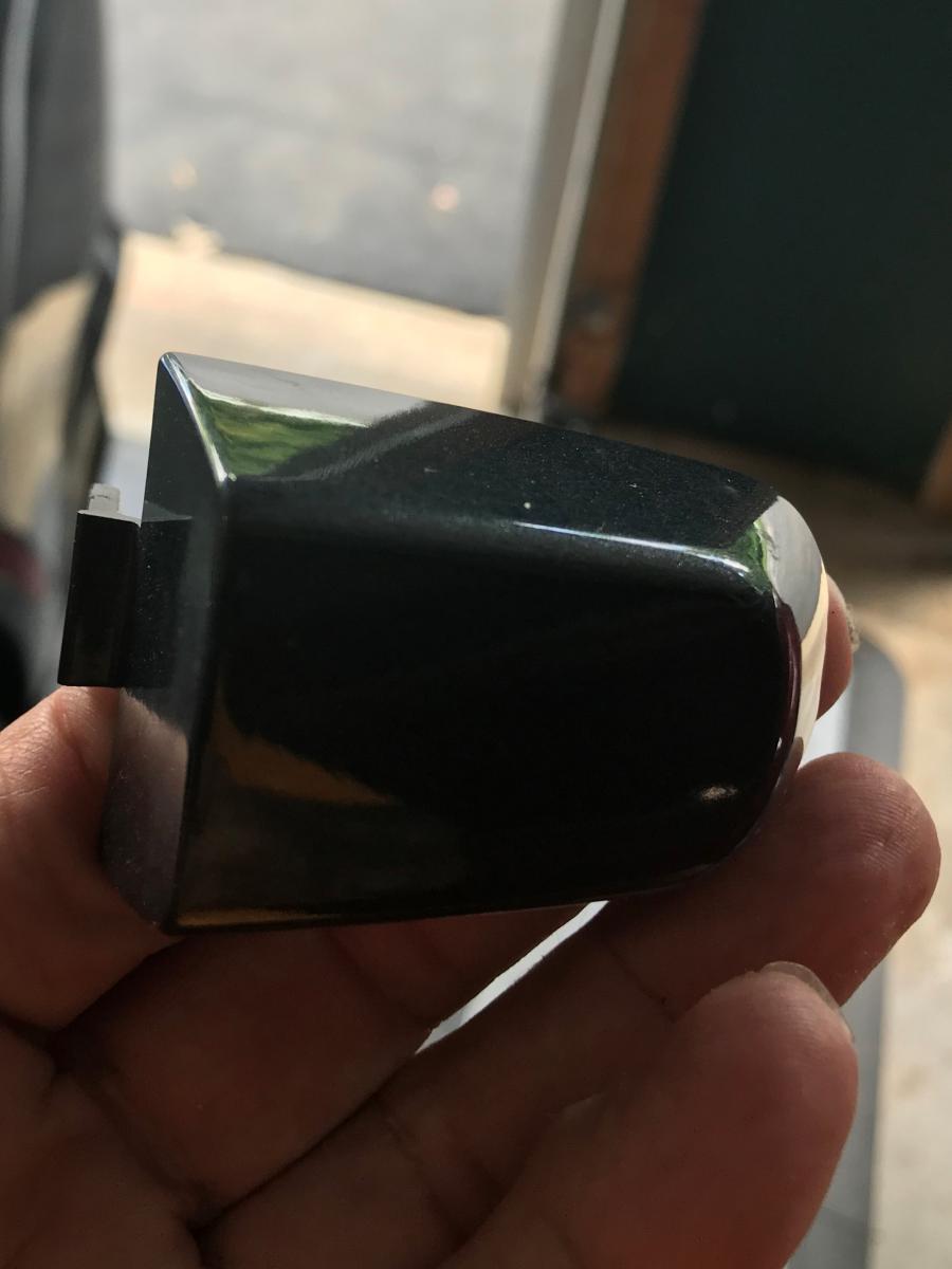

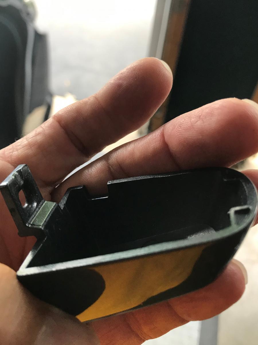

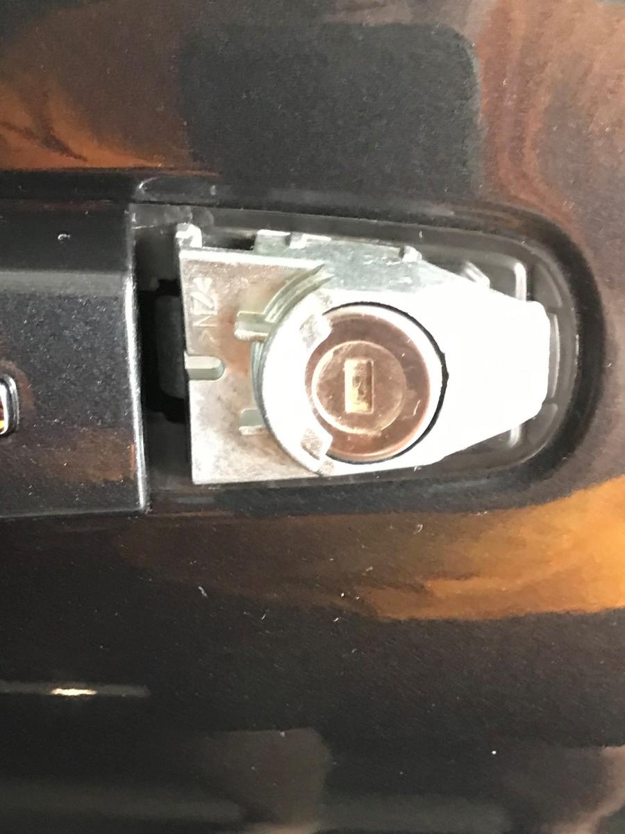

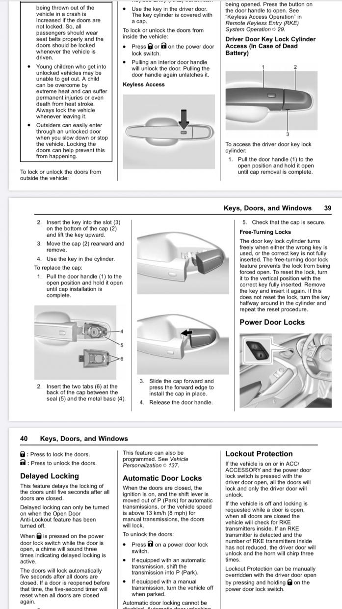

Key Access on the Driver's Door
Afternoon,
I was thumbing through the owners manual and came across this. I am sure there is a post about it somewhere on the forum, but I figure I would pass it on anyway.
