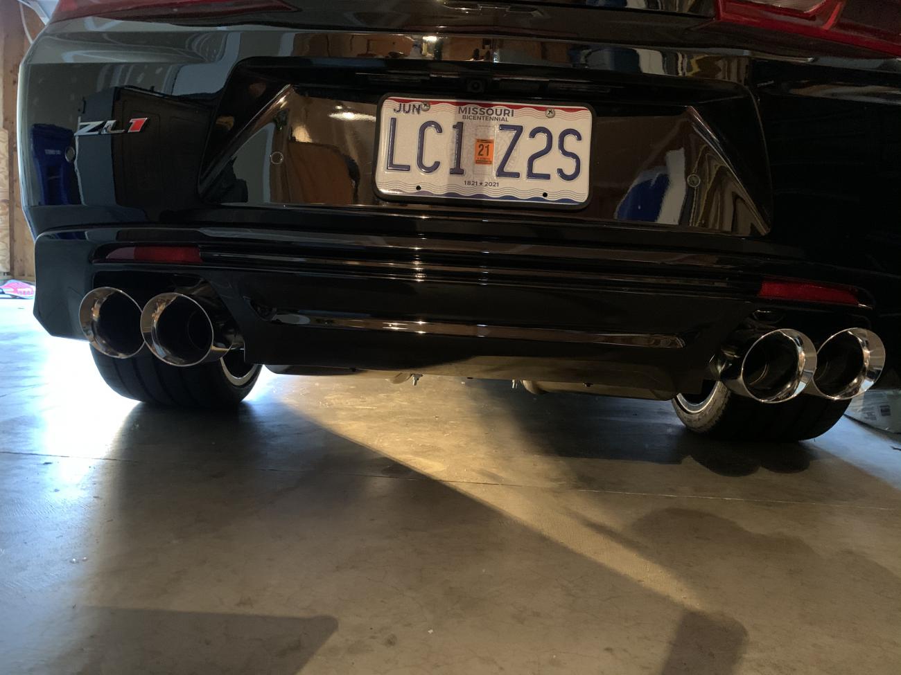

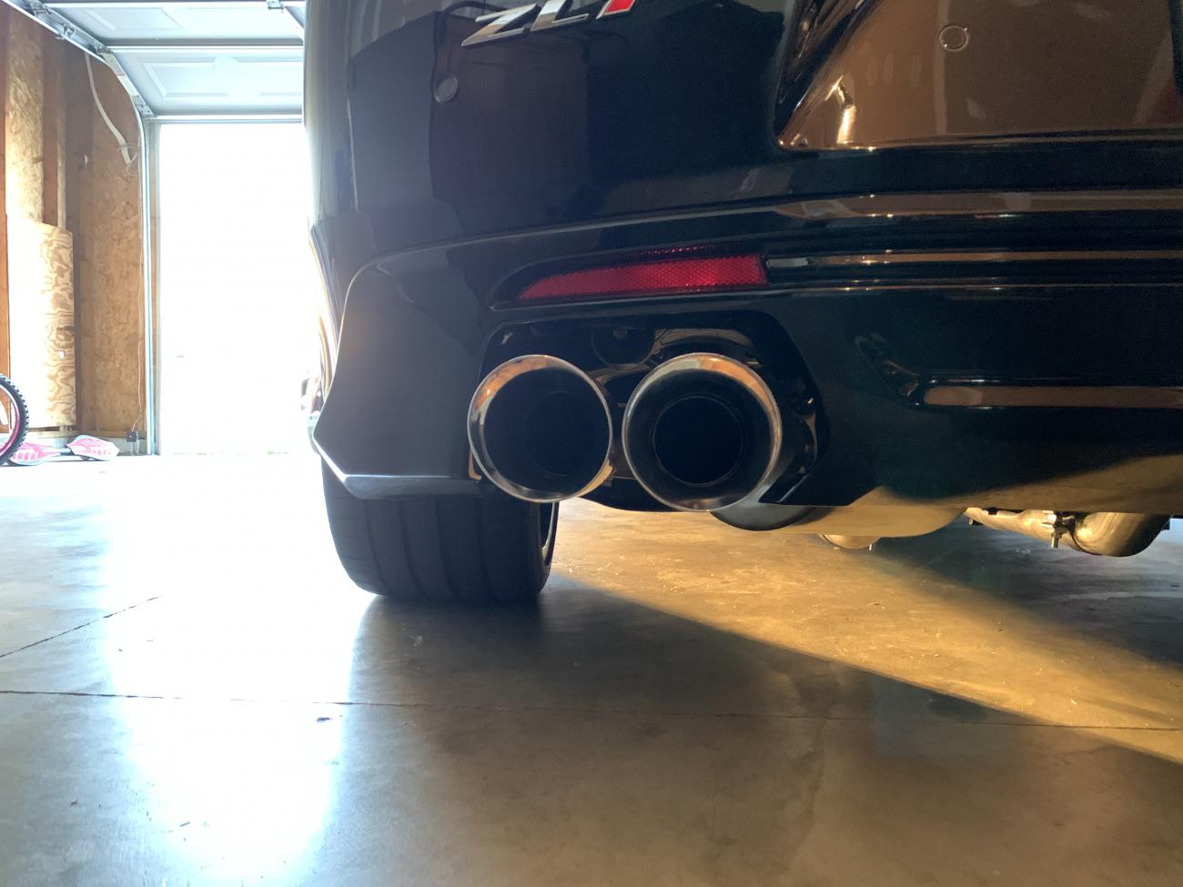

Let me start by saying I love the look and the sound except… the passenger side tips are a little crooked. I’ve loosened the clamp that connects the muffler and tried to twist it into place but can’t get it any closer than the picture below. It seems like the hanger just won’t allow the muffler to turn enough to get them level. Any suggestions?

I don’t think this is a tip adjustment issue but rather the muffler needs to be rotated. I’ve taken the tips off, loosened the exhaust clamp, and attempted to rotate the muffler clockwise so that the inner exhaust outlet goes up. But the rear hanger is keeping the support bar from going down which is where it needs to go when I rotate the muffler. I’m not too keen on taking a prybar to try and bend it but I honestly think that’s the only way to get it in the position it needs to be for the tips to be level. So I’ll probably just have to live with a droopy tip and a great sounding exhaust.

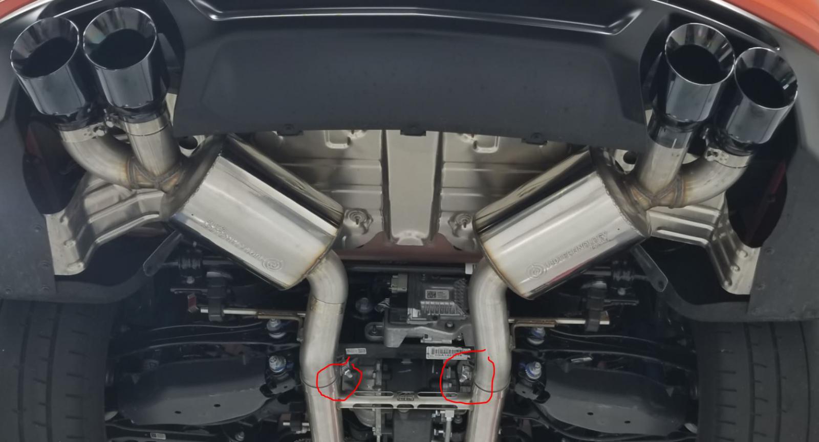

It's not the tips.. that's mostly for adjusting how far they stick out. As mentioned take the tips off and you will see the pipe is most likely not straight. Or just leave them on and loosen it up further forward to adjust.
Loosen here and then use the tweek method.
Attachment 1035540
Yep. That’s the clamp I referred to as the exhaust clamp. I haven’t Tried sliding the muffler further in or back and rotating yet. Maybe that’ll give the pivot point it needs.
jeffinstl is offline   Reply With Quote
Old 06-17-2020, 07:40 PM   #14
Posts: 38,040
Yeah that should definitely fix you up.
