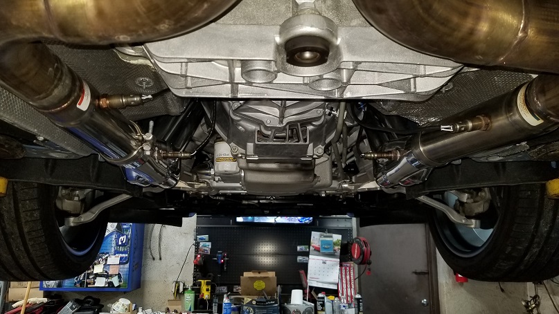

I installed 2" catless Kooks with borla 60606 and ATAK NPP exhaust. We welded the Kooks connection pipes to the Borla 60606. I also put the 60608 resonator in the mid-pipe.

Thank you. How did you determine where to cut the 60606 on the passenger side to get rid of the flange?

Just mocked everything up. Marked and trimmed the Borla mid pipes leaving them a little long and did a final trim/grind to get them to fit nice.
