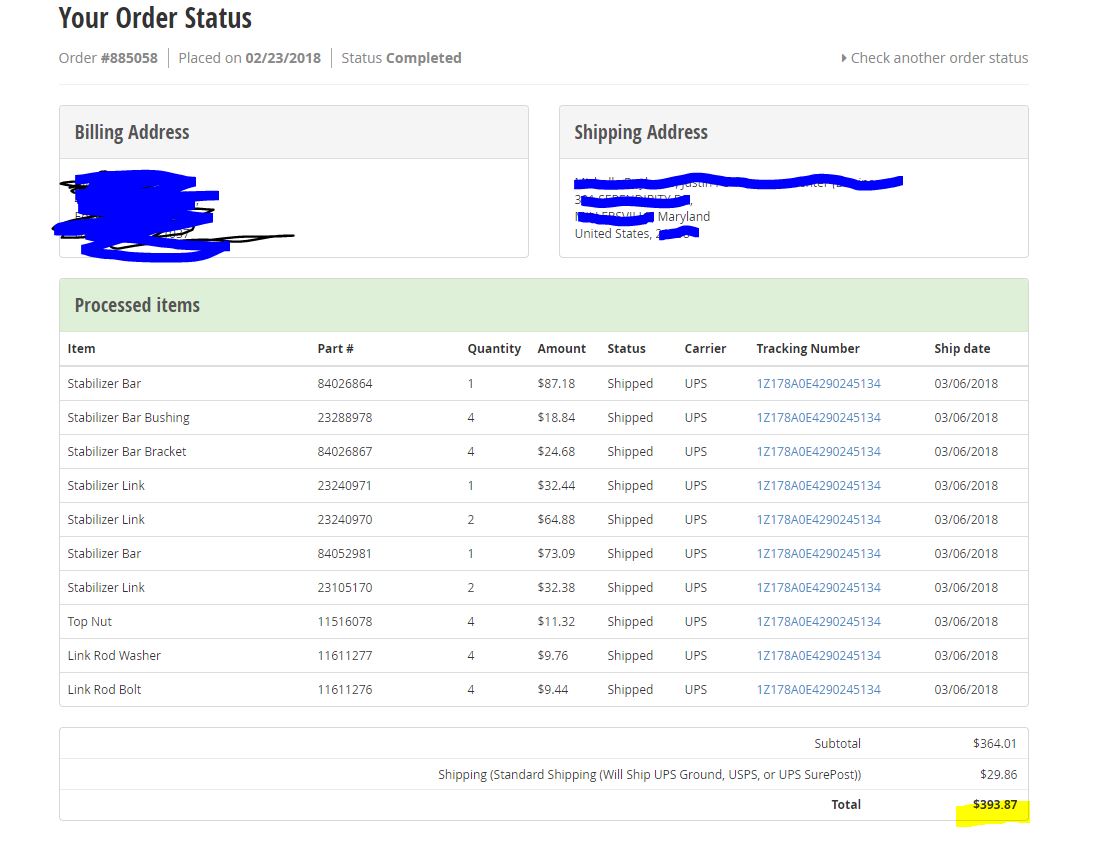

You might consider the GM upgrade alternative of the ZL1/FE4 level suspension sway bars for *both* front/rear. I asked the same question you did 2+ years ago for my 2017 SS 2SS A8 with MagnaRide and reviewed many threads here on the subject. BMR solution was mentioned but some thought them just too much. (Don't get me wrong -- I love BMR -- the rest of my suspension other than springs has been augmented with their replacement parts or bushings). A very persuasive thread then focused on upgrading SS with ZL1 bars (and links) -- stiffer than the SS bars -- and reasonably priced. And to ensure balance -- both front and rear bars were upgraded. I went that route (along with Eibach lowered springs) and my car hugs the road like a slot car (Michelin PS4s on MRR017 staggered 10/11" rims help too). Roll around corners was reduced, car felt tighter subjectively, and it remained quite comfortable to ride in. That balance of ride quality and handling was key since until last year I used the car in Daily Driver role commuting 80 miles round trip a day. Parts list is attached for everything involved.
