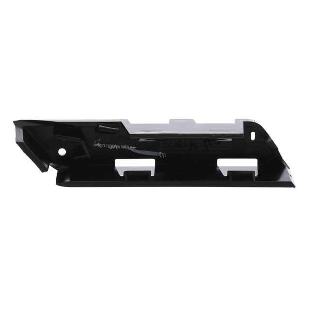

I think what you’re looking for is part no.: 84021428 and 92225495.
See no 8 and 9 on this page:
https://www.gmpartsdirect.com/auto-p...omponents-scat

Same here, car came without the SS emblem on the front grille. Are only items 8 and 9 part of the assembly? I think item #10 is also required for fitting the emblem. Can someone confirm as I am looking to buy one as well?

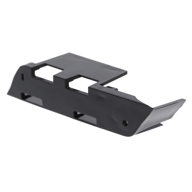

Yes, you need (10) also. It's the backing plate that holds the rest on it on. 8 and 9 are the badge and bracket of course, and they slide onto the grille nice and neat, but there's nothing holding it on. You get your hand up in there and pop the backing plate on and it all holds together.

No, you do not. ...here's a quick diagram and photo. Mine isn't on the car, but I sorta placed it on the grill so you get the idea. Reach 3 of 4 fingers through the grill and find the back of bottom edge of the main bracket. You'll wanna gently pull it down, kinda like you were trying to roll the emblem on front, up....if that makes sense. When you do, the backer will just drop out, and the whole badge will simply come off the front. Try to have your other hand ready to catch the backplate. I dropped mine down into the grill. Had to retrieve it with one of those little parts grabbers! -I wouldn't do this in the cold either. Wouldn't be hard to snap the bracket.
