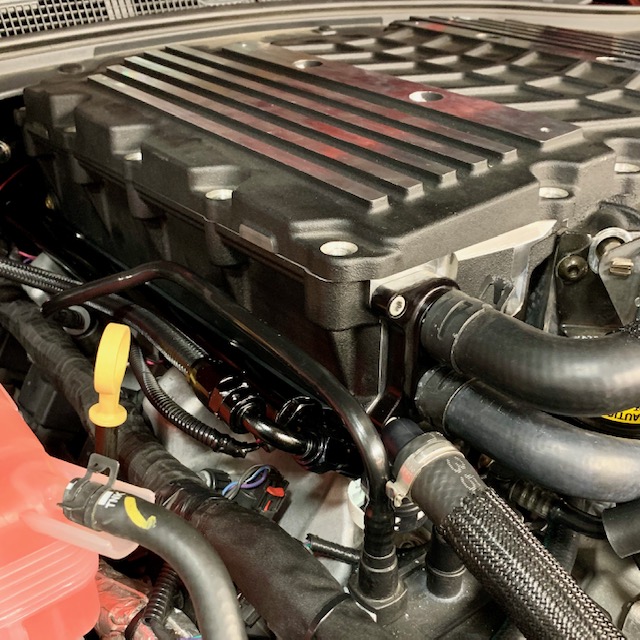

Nice plan, pretty much exactly what we have done with my son's car, his is an otherwise stock 2018 1SS (like Greg's) with a 2650 and made 600 RWHP on 91 pump. It was pushed to the absolute limit of the stock LT1 fuel system so we spent the quarantine time developing a port injection system for the Magnum 2650 on this otherwise stock vehicle and have been vehicle testing for about 2 weeks now.
With the port system and our dual in-tank pump system, we are now running full E85 at 11psi boost and over 20 degrees of timing. Currently waiting on more pulleys from Magnuson and then we'll bump the boost a bit more and then head to the dyno. We expect to be right at 750 RWHP on the E and just under 600 RWHP on pump.
Not really much to see as it's mostly hidden by the blower, but here are a couple images
Attachment 1030660
Attachment 1030661
Pretty cool, and you made this stock pistons, stock cam?
Attachment 1030660
Attachment 1030661
Do you have more pictures you can share when you have time?
Will do soon, my son did a beautiful job on this - if you have a 2650 Magnum already, it's a simple bolt-on setup for that blower.
He's finishing modeling for one on my C7 Z06 LT4 right now, can't wait to ditch the meth and just fill with E at the pump. I'm sure I'll be at 900+ with the vette in no time!
