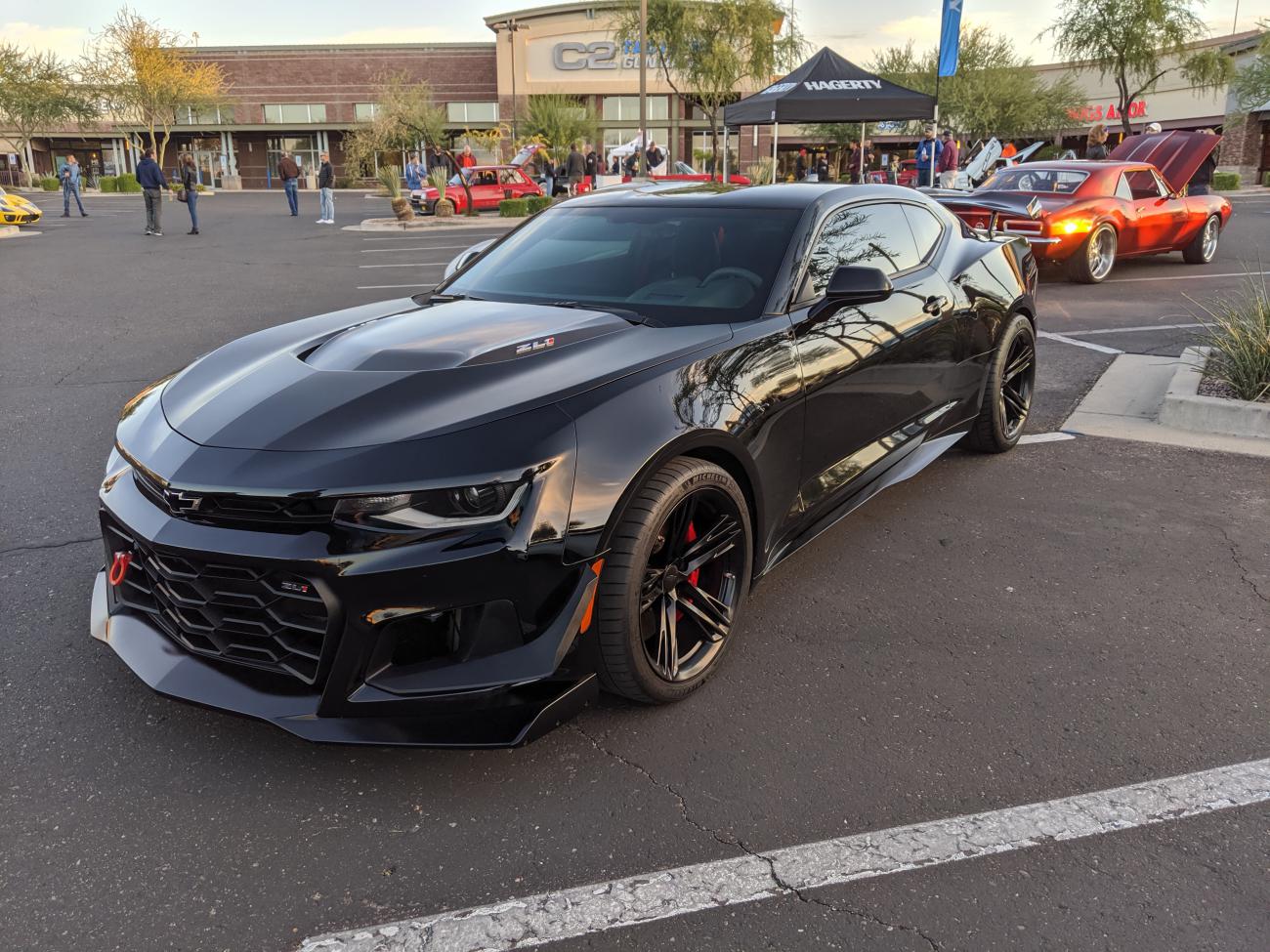

I run PSC2s in 315/30/19-F 345/30/19-R on track and tested these in the most grueling G forces of the banking at ACS in Fontana. They fit no rubbing, or at least none that cuts the tires.
345 PSC2 looks badass on the ZLE, this may be the only tire that looks more badass :-)
I used to think 285/30/18s on all corners looked wide on my Evo X.
This is some damn good information you're posting.......
Is this photo 315/30/19 - 345/30/19 ??

Fortunately Kuhmo now makes the V720 in 305/30-19. Mine will be here Tuesday. I assume running the 295/25-19 would potentially mess with the computers head lol. But that’s not a problem now. I will go grab a pic of the sidewall.

Originally Posted by SFV1LE View Post
I really like these as a track tire option for the price and performance, I dont think 325 3R will fit in front on ZLE.
You can either run 305 3R, or 315 Hoosier R7 or 315 PSC2. I'd try the PSC2 first because the idea is to have a set of 4 that wears better than 3R, and nothing wears faster on track than 3Rs on the front of a ZL1.
People have run 335 square Rivals on an SS on track. A 325 G3R can fit a ZLE for sure with the right spacer.
Originally Posted by 2018$S1le View Post
Yeah I doubt the 325 would fit up front too. It’s one thing to add width in the back where the wheel only moves up and down, but up front there’s also the turning to consider. I will have to pass on being the crash test dummy for that one lol. Here’s a good pic of the new rears.
See above, but I don't blame you for not wanting to be the tester.
Completely different tread compound though. The non-ACR V720 is an autocross only compound that won't hold up to tracking. Not an issue if you don't track.

No one knows on the ACR front tire, but just like I told you, everyone thinks the huge diameter difference will cause a problem. You are going to have to be the first one to try it on a Camaro if you really want to know. I just bought 4 of the front tires to run square, like Coby is running on his SS1LE in Gridlife time attack. I'd love to run the ACR rear tire, but I'm not spending the money for another set of rims with at least a 12" wide rear right now.
