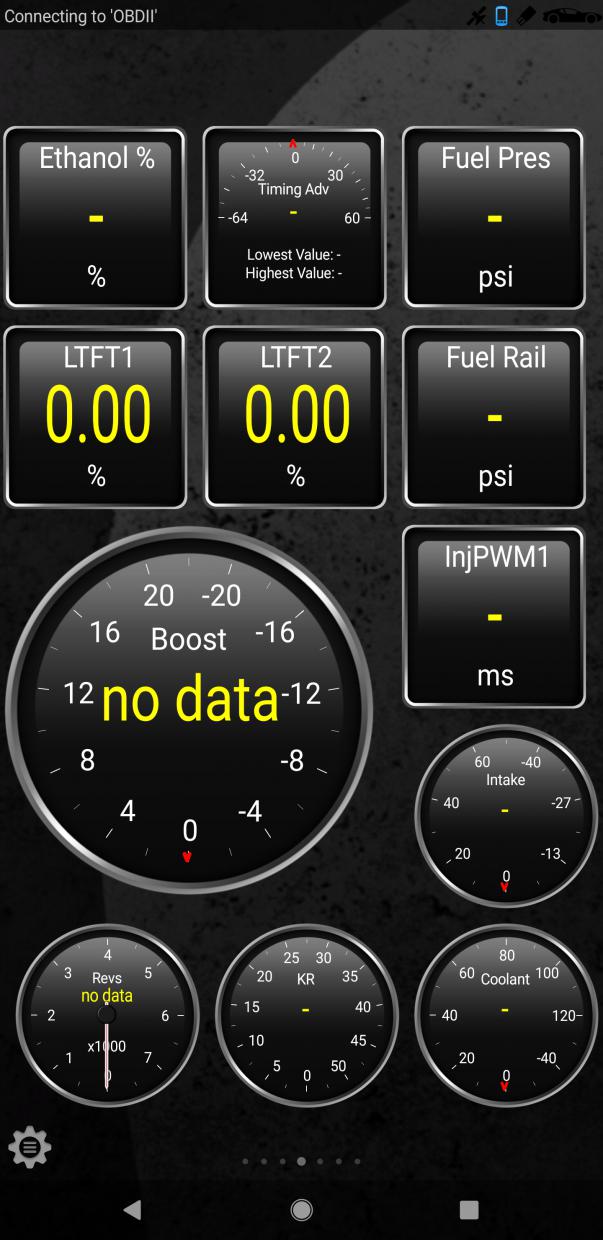

you can use the Torque pro app on a tablet or phone with a bluetooth obd2 device and scan most engine parameters including boost.

Here is a screen shot of the layout on my Torque App for reference.

No I don't think so but I agree it would be nice.
Looks good, King. Any custom pids needed, other than e%?
I still have not been able to get my pid for e working on my galaxy s10e.
nope. E content is the only one that requires a custom pid.
