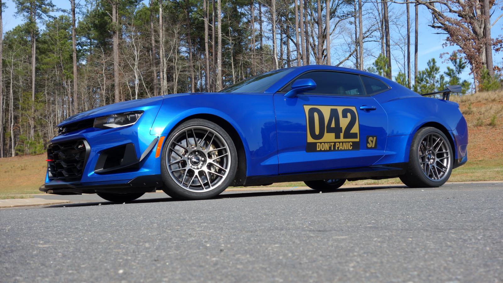

This is on a ZL1 with 1LE aero. You might consider running 19x11 on all four corners. I don't see much benefit in running 19x10's up front.
Front 19x11" ET11 Anthracite APEX ARC-8 Camaro Wheel
Rear 19x11" ET43 Anthracite APEX ARC-8 Camaro Wheel
305-30-19 RE71R on all four corners
