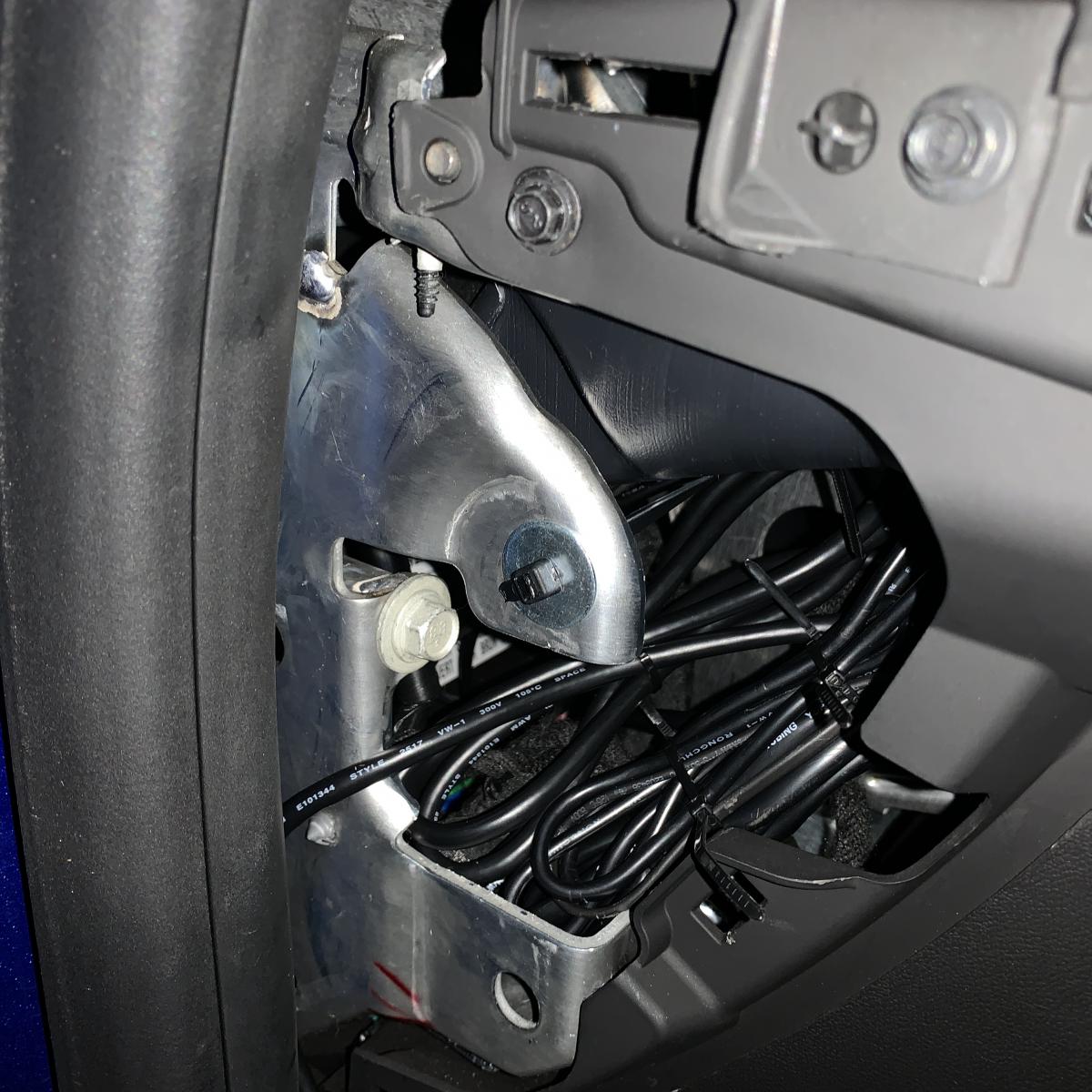

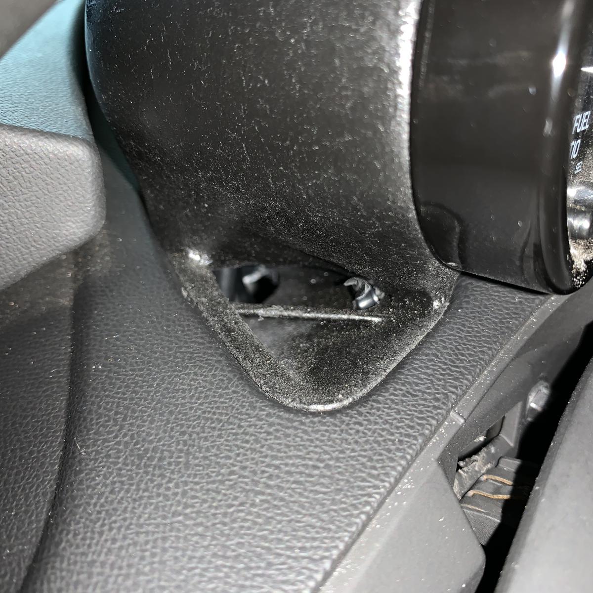

Now that I could pull the cover off and take a look, I can see what I did exactly
I drilled the hole right under the base of the lower gage, then ran one zip tie thru it and I zipped it back on itself. I then left the long tail on it, ran it thru the hole in the bracket on the metal on the left side of the dash and thru a washer on the far side. I then used the head off of another tie to put tension on everything. It is not strung tight, but not loose.

Originally Posted by DorkMissile View Post
I have a dual gauge pod that goes in the defrost vent. AEM wideband in the lower hole, iDash in the upper.
I never had much luck gettin the pod to stay put using the snap in tabs - so what I did is drilled a small hole in one of the ribs on the underside of the pod, then looped a wider zip-tie thru the hole. I then strapped the zip tie around one of the metal braces in the dash that you can see on the left side of the dash once you remove the side cover.
Thing is locked in solid now.
This is very helpful. Thanks for sharing your creativity!
Awesome! I may try this
