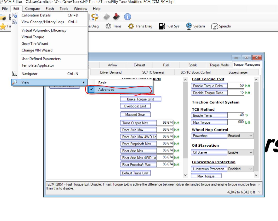

Originally Posted by grampa_ss View Post
Can't see any ECM info. Tried ver 4.4.4 and the beta. No go. I did see TCM info.
Are you in the "Advanced" view?
Also by the way, i'm not the OP, I just posted my tune file so the OP could look at it and see what I changed. Unless you just wanted to look at my tune? thats fine, its good to share tunes around here so people can learn if they are willing to put in the time and effort.
