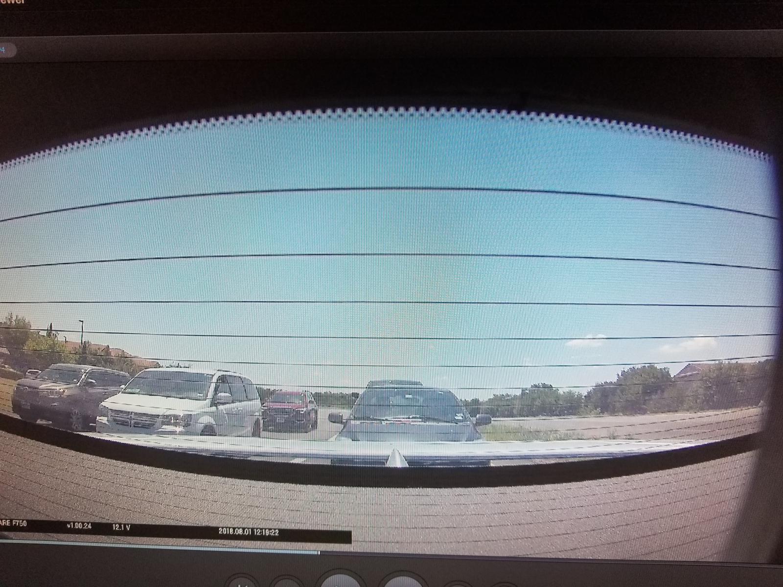

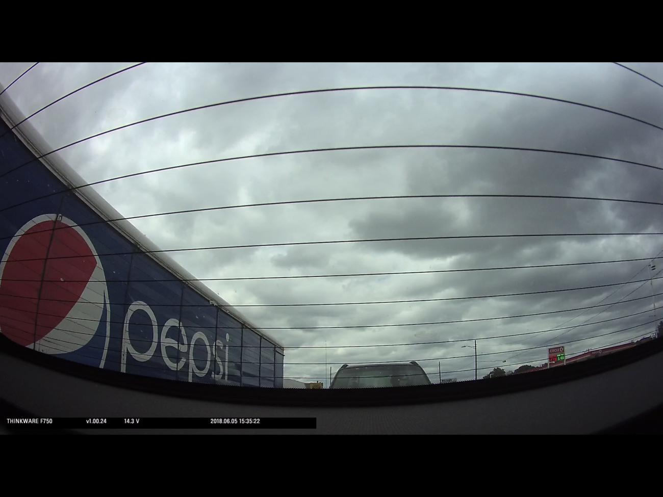

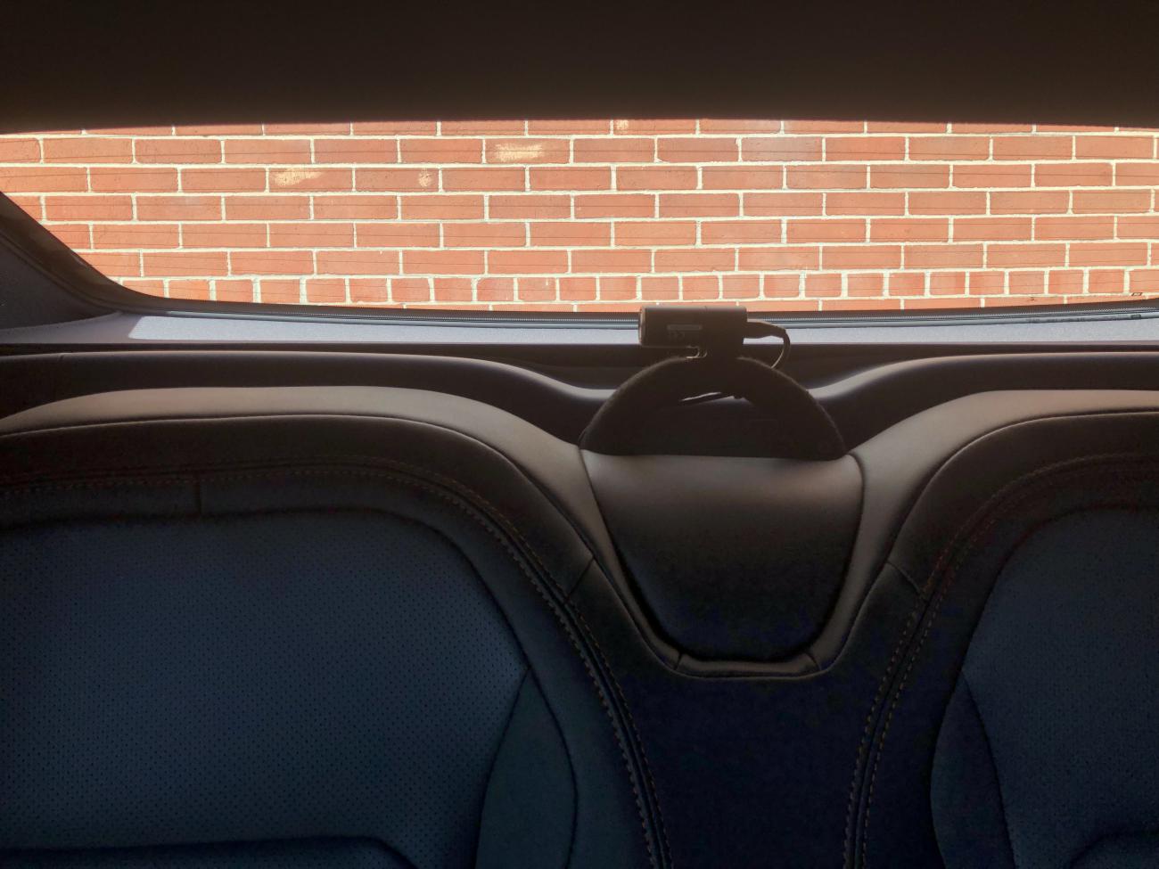

I know the struggle. I settled for a solution that gives me okay but not great visibility out the back. Here’s my setup and what it sees out the back with the top up. So basically, in “parked” mode. I would be able to see faces of vandals, but not plates of vehicles that might bump it in the parking lot.

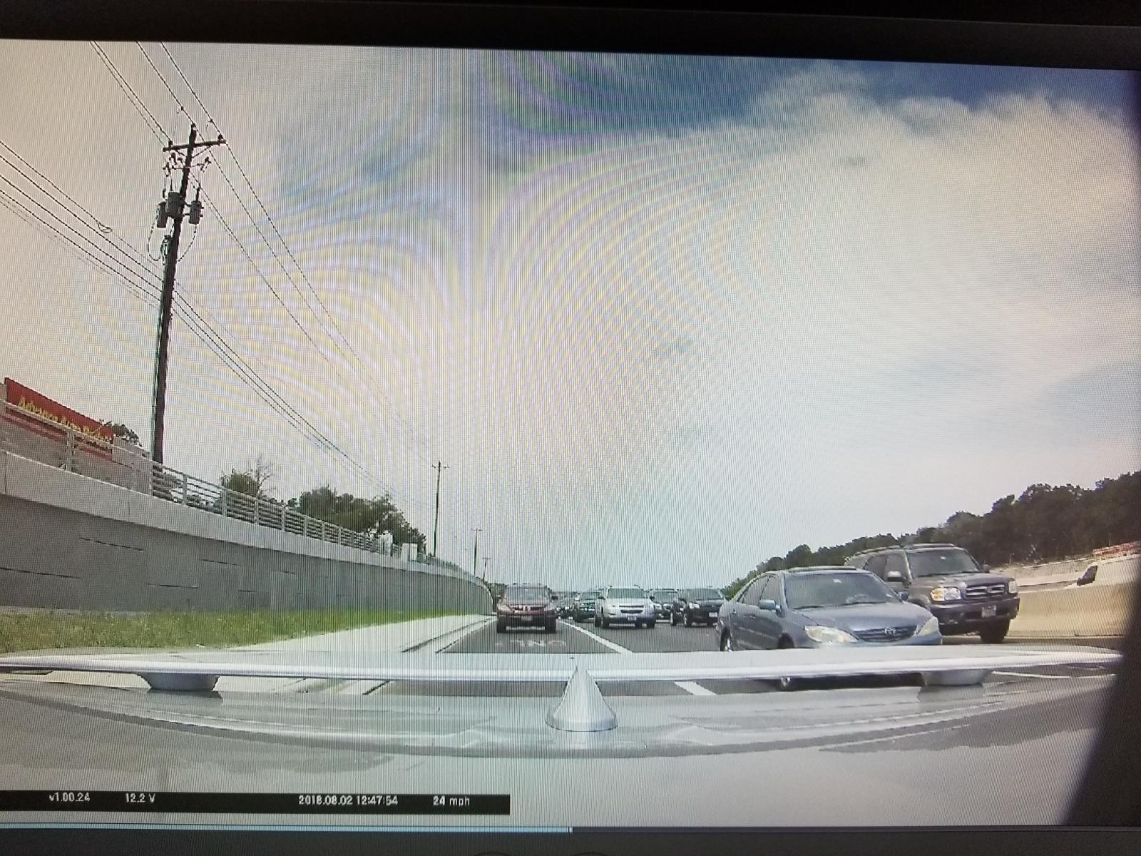

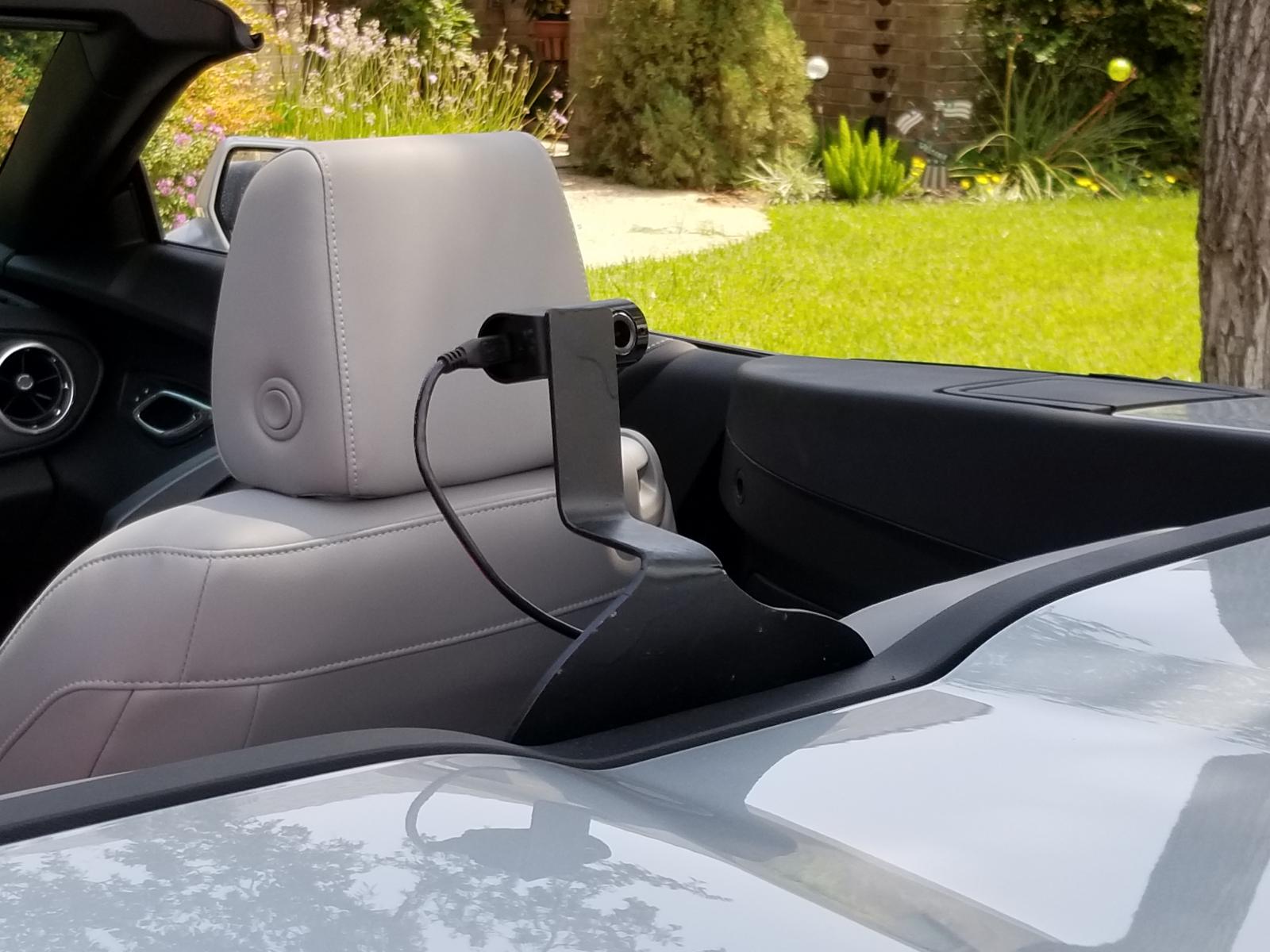

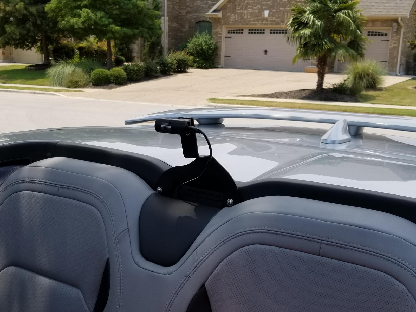

I made this out of 1/8 inch aluminum. Had it cut and bent, and then I painted it installed the camera. It is angled forward to give clearance to the top. I have a pretty good view out the back.

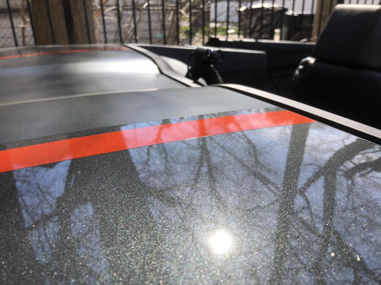

Just had the stripes added

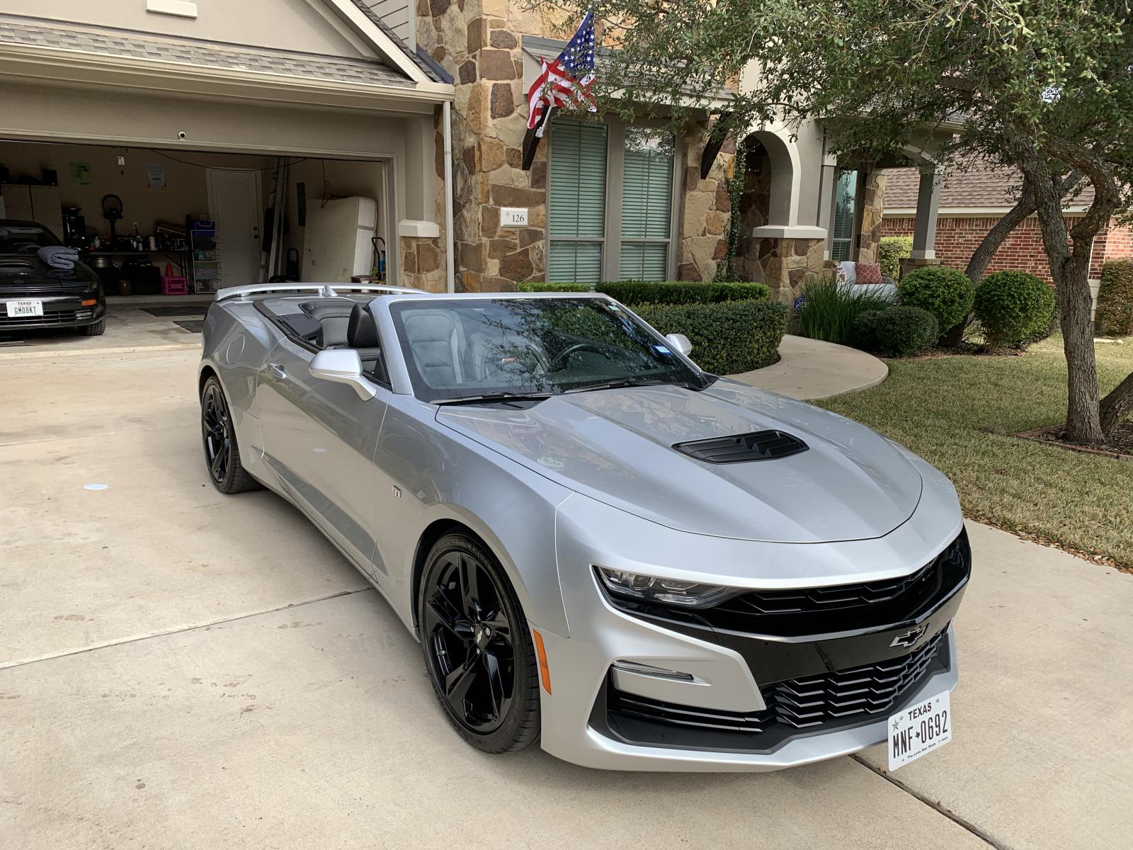

My 2019 Silver Vert. My 1st car (in HS) was a 1967 RS Blue/Silver Vert.
