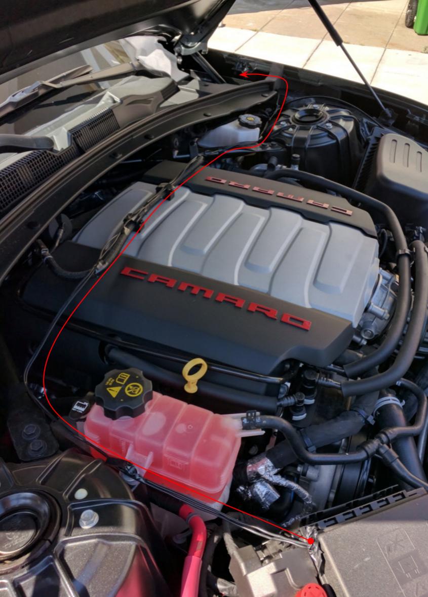

I was able to successfully set up a switch connecting to fuse #51 by following the thread (http://goo.gl/CXC30n) created by 'Theta' from 'corvetteforum'. This thread only shows how I installed it on my 2016 Camaro. Feel free to get even more creative beyond my easy route!
Total amount spent: ~$20-25
Lumision ADD-A-CIRCUIT ATR MICRO2 FUSE - $7.99 (Used spare fuse to create a custom spade-terminated wire that goes into the lower right slot)
http://www.amazon.com/gp/product/B00OZGA8O8
16 Gauge primary wire - $7.49 (Cut equally in half)
http://goo.gl/MMkihm
Dorman Conduct-Tite - $3.99 Rocker Switch (I didn't connect the copper terminal for the LED light since it's not required)
http://goo.gl/MLDyNl
Black Electrical Tape - ~$3
Video of switch in action: https://youtu.be/3NsOFOHUri8

Sorry, great idea, but the execution reminds me of the kids in high school who routed their amp wires trough their doors because they didn't want to find a better place for it.

my god , use some slit loom, wires as is, look tacky going across engine...

Posts: 65
I'll admit the execution was not the best, but it gets the job done. I was short on time and couldn't find a better place to route it without having to take something apart, if any. The engine bay/firewall is sealed pretty well.
Slit looms will be my next step. Due to time, this was my test set up and will refine it later.

If anyone executes this its a good idea to have the wire go down (twords the ground) before entering the fuse box. Waters natural progression will lead right to it with that run. You can also run the cable from the bottom of the fuse box up into it.
Fish tape is yo friend.
