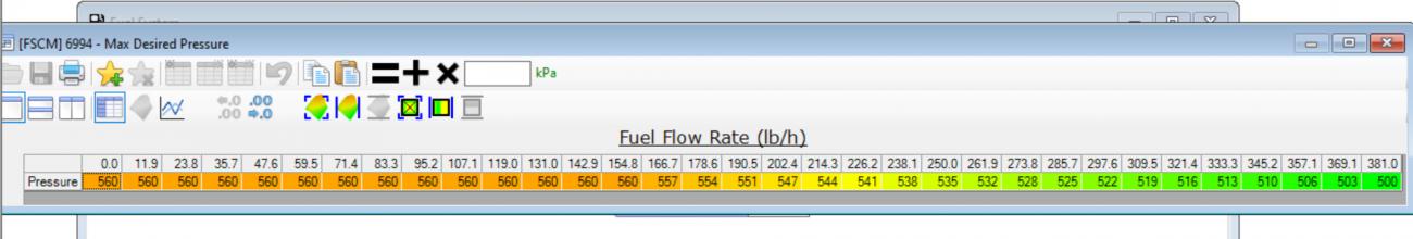

Originally Posted by grampa_ss View Post
Can you tell me where the fuel pump voltage is in the FSCM? I have my tune pulled up and I see my AFM/NPP valve settings, so the FSCM is loaded. But System/General/Alternator - I see the "fuel system voltage min"...but that's in the ECM. as a matter of fact, everything under alternator is in the ECM.
Sorry, just saw this post now. I did a quick check and it's max pressure, not voltage being adjusted in the FSCM. See attached. You can also adjust pump duty cycle and regulation pressure too.
