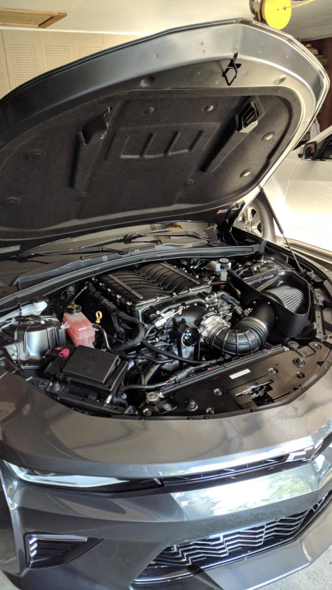

So after careful consideration I have decided to go the F/I route. I am going to assemble all the pieces and parts so as to spread out the cost over a few months and then take it up to Brett at Pray for install and tuning. I already bought the Whipple during the black friday sale. My goal is high 600's in HP, but still maintain street manners. Here is what I am looking at:
Whipple S/C
LT4 high side and low side
LT4 injectors
TSP Headers
NW 103 TB
Big Gulp Rotofab CAI
New plugs and wires
JMS Fuel pump volt booster
Possibly Alky Meth injection with trunk tank
Pray performance tune
Borla Axleback NPP exhaust
What am I missing and any other suggestions?
Thanks
