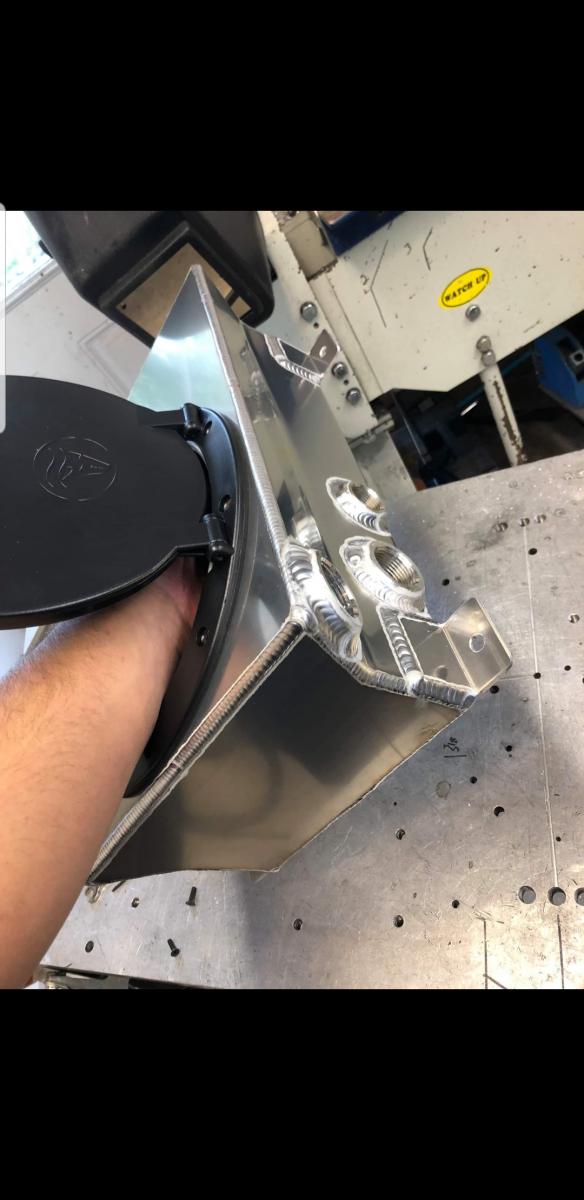

Picked this up for the wife's car made by Outlaw Racecraft!
Shouldn't need to move any electronics just need to grind down the studs sticking up that hold the black foam part.. thinking the pump can go in the open space..

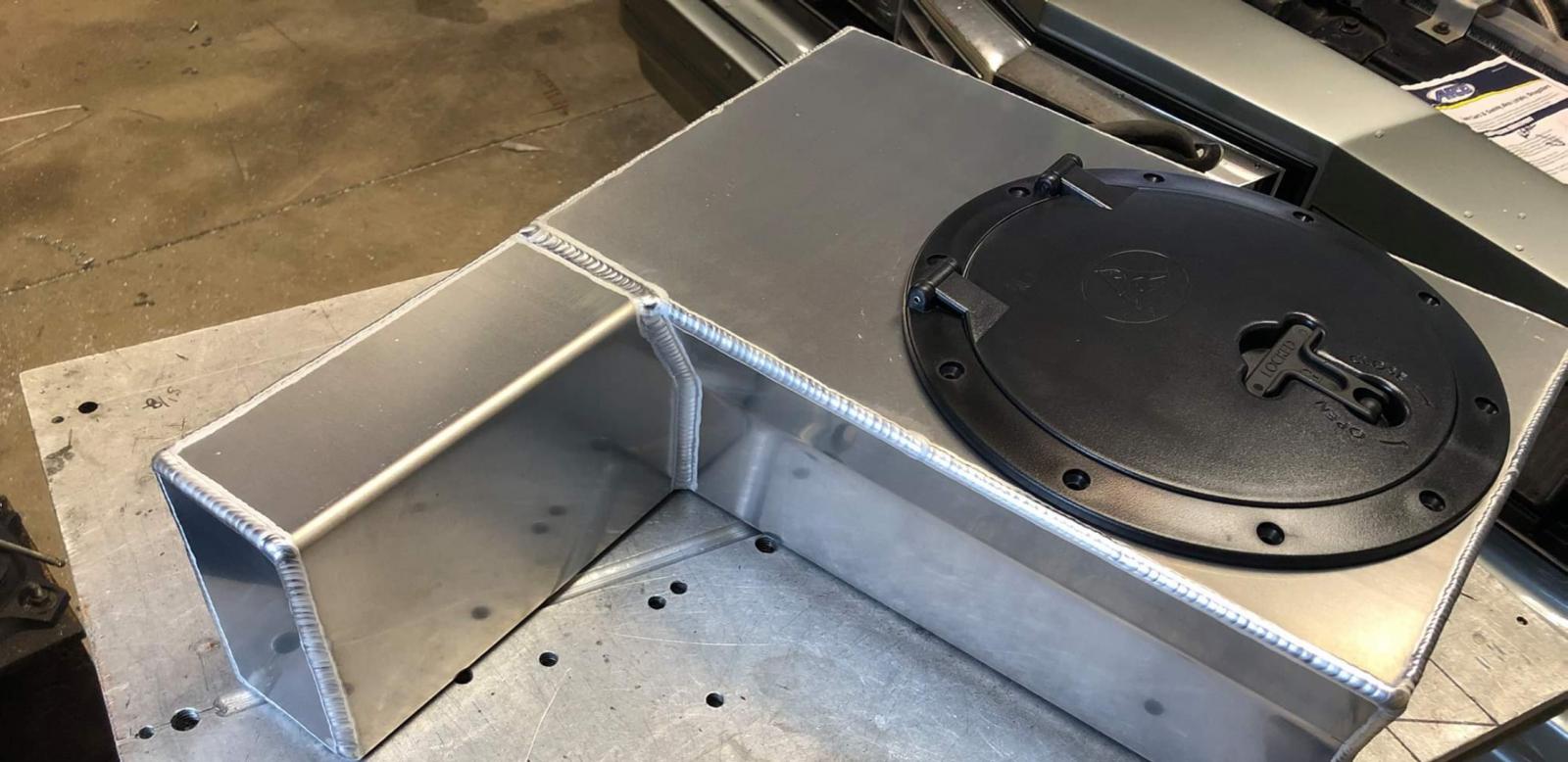

Looks like a great fit. What is the reason for the slope in the top or is that just an optical illusion the way its sitting on the bench?

Only so this lid would fit. Was told this is one of the best sealing lids. So when I built the card board tank then gave dimensions to outlaw he said he needed to do that so I added the wierd angle to make sure it still cleared the electronics.

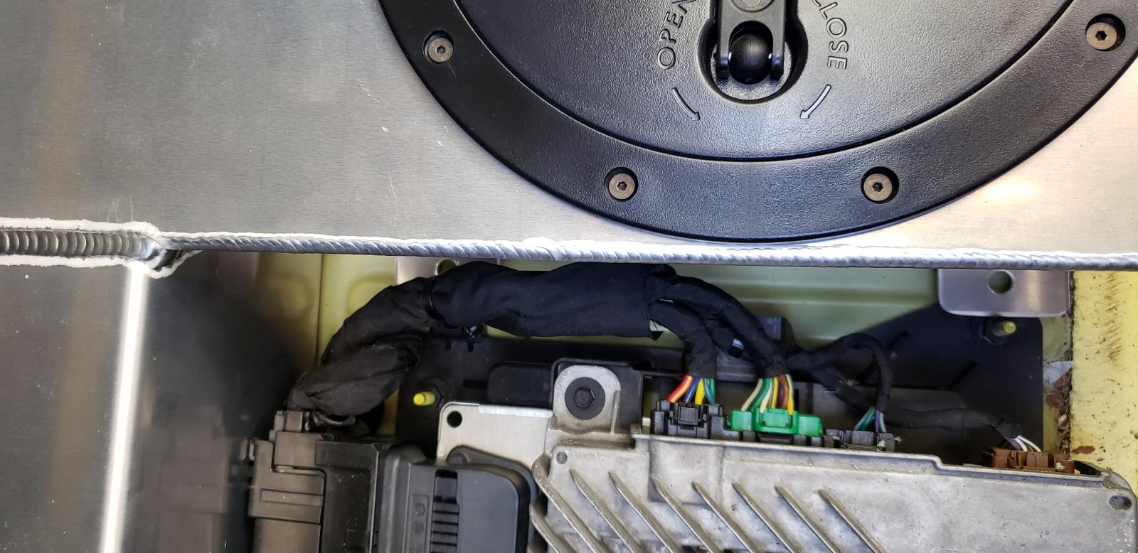

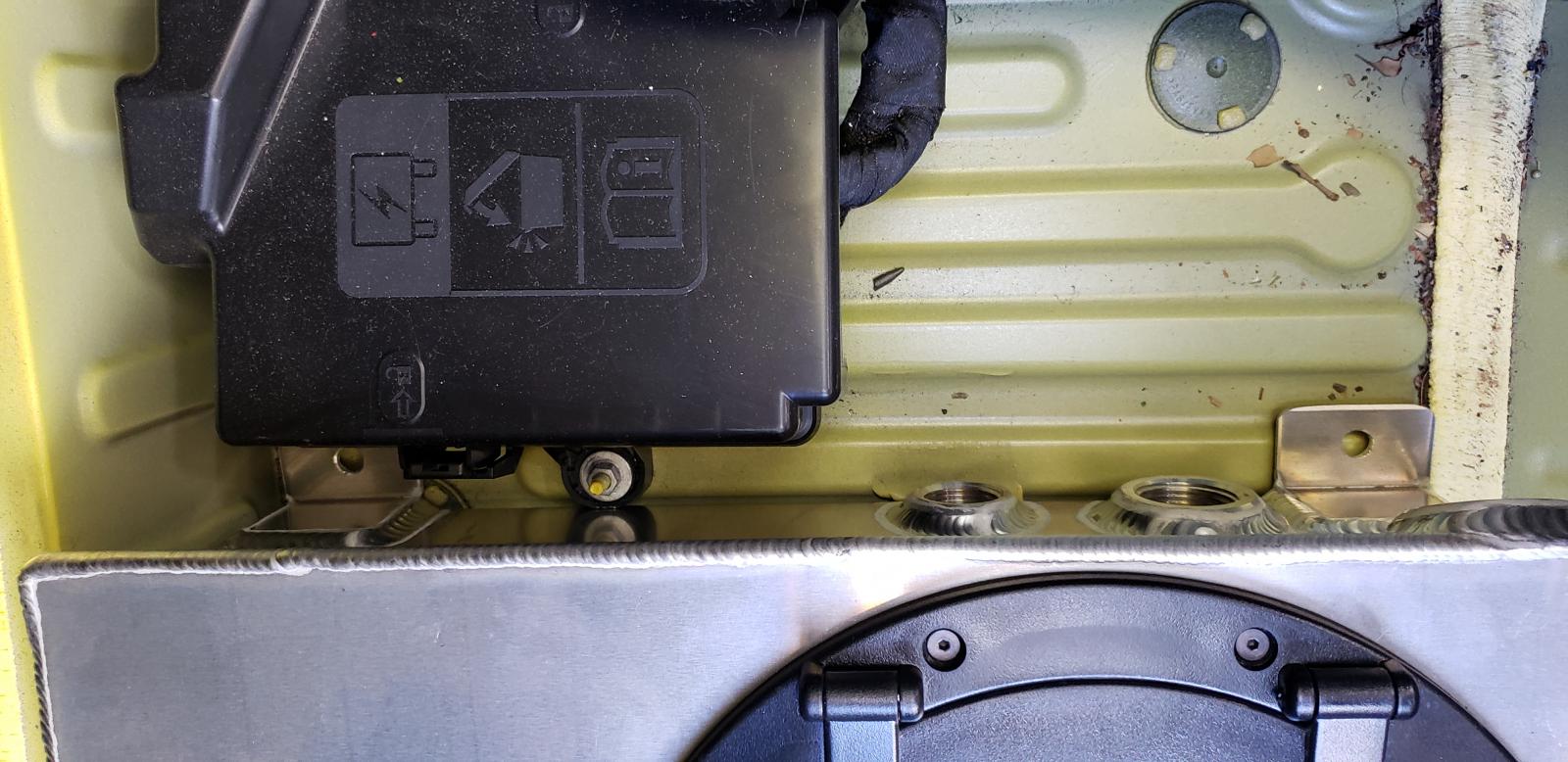

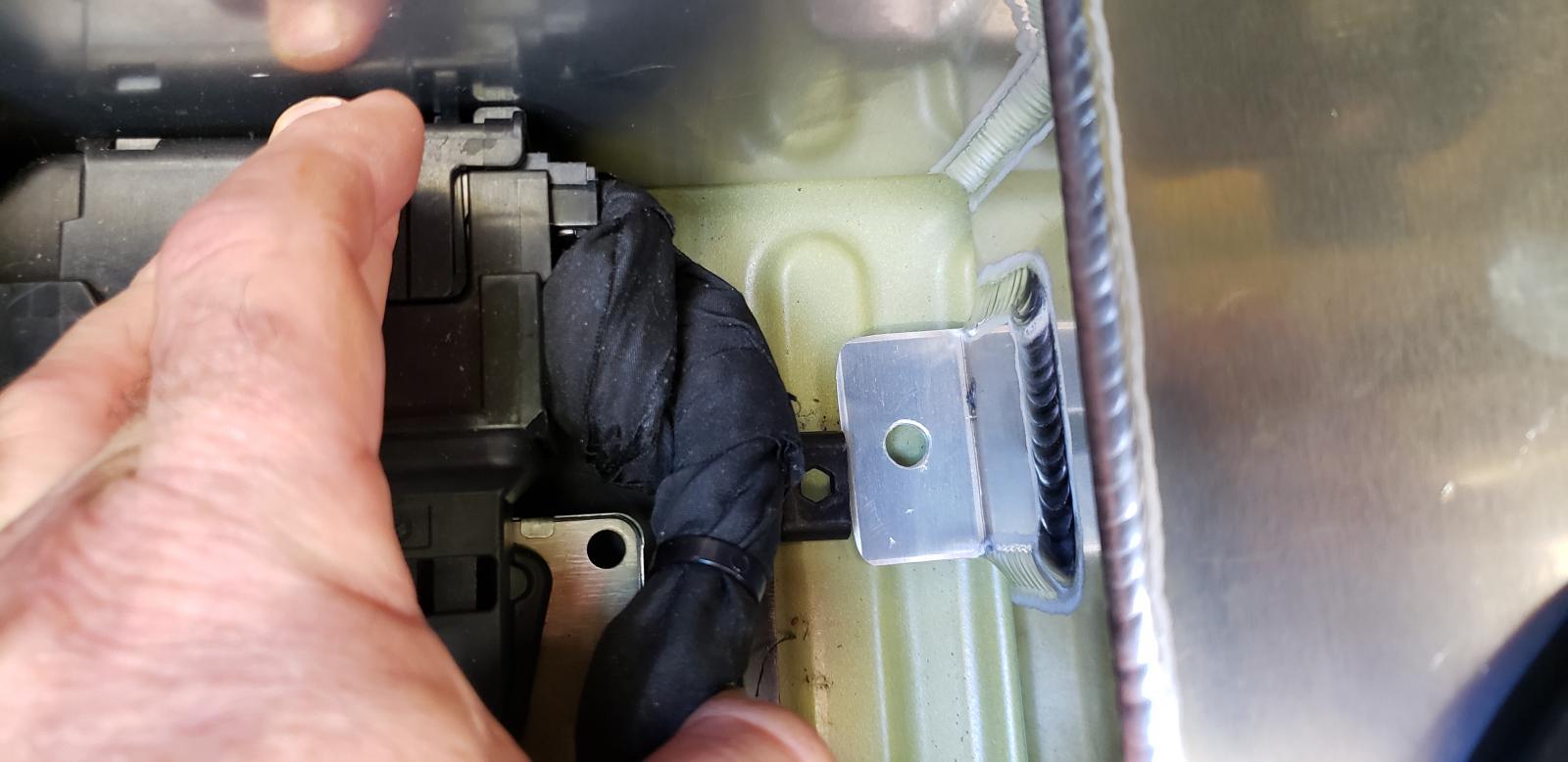

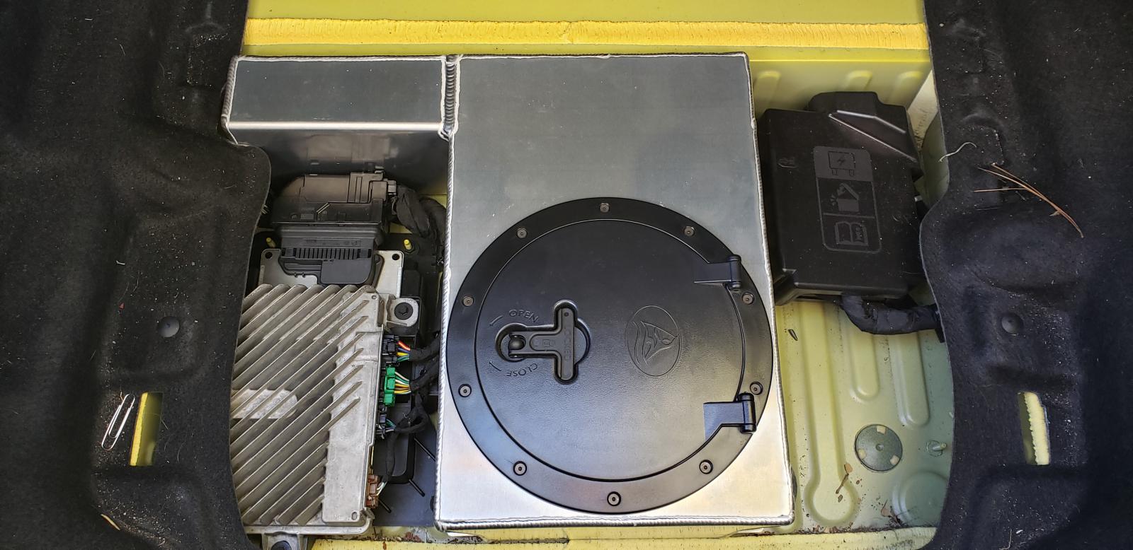

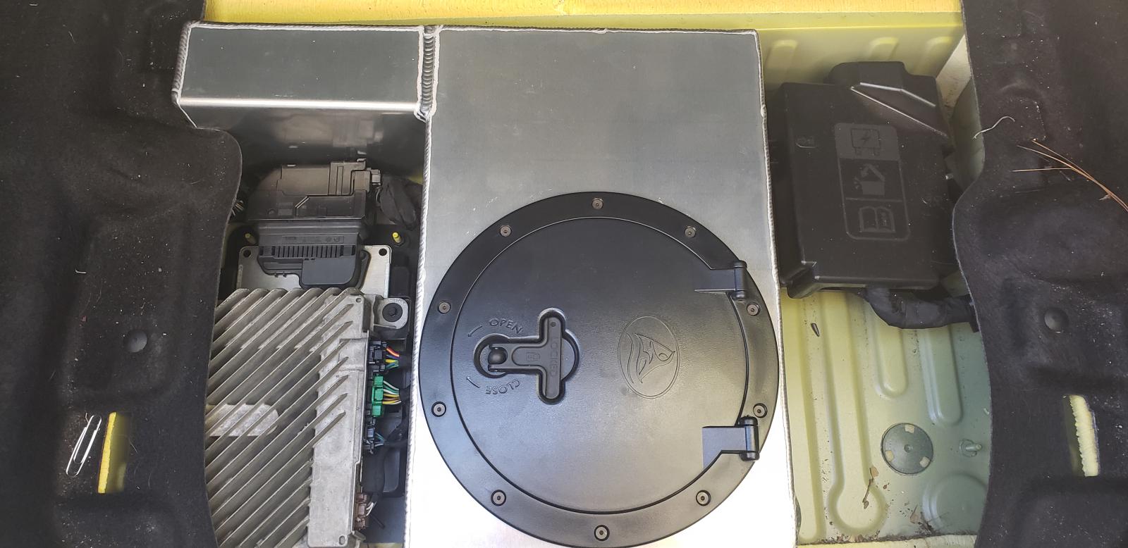

Quick test fit so just cut off the 2 studs that hold the foam part in the trunk.. about to order the AN fittings and pump for wifes SS and my Zl1 I went with a little larger and will have to relocate the modules.

Very cool and tight fit but that's a good thing.
