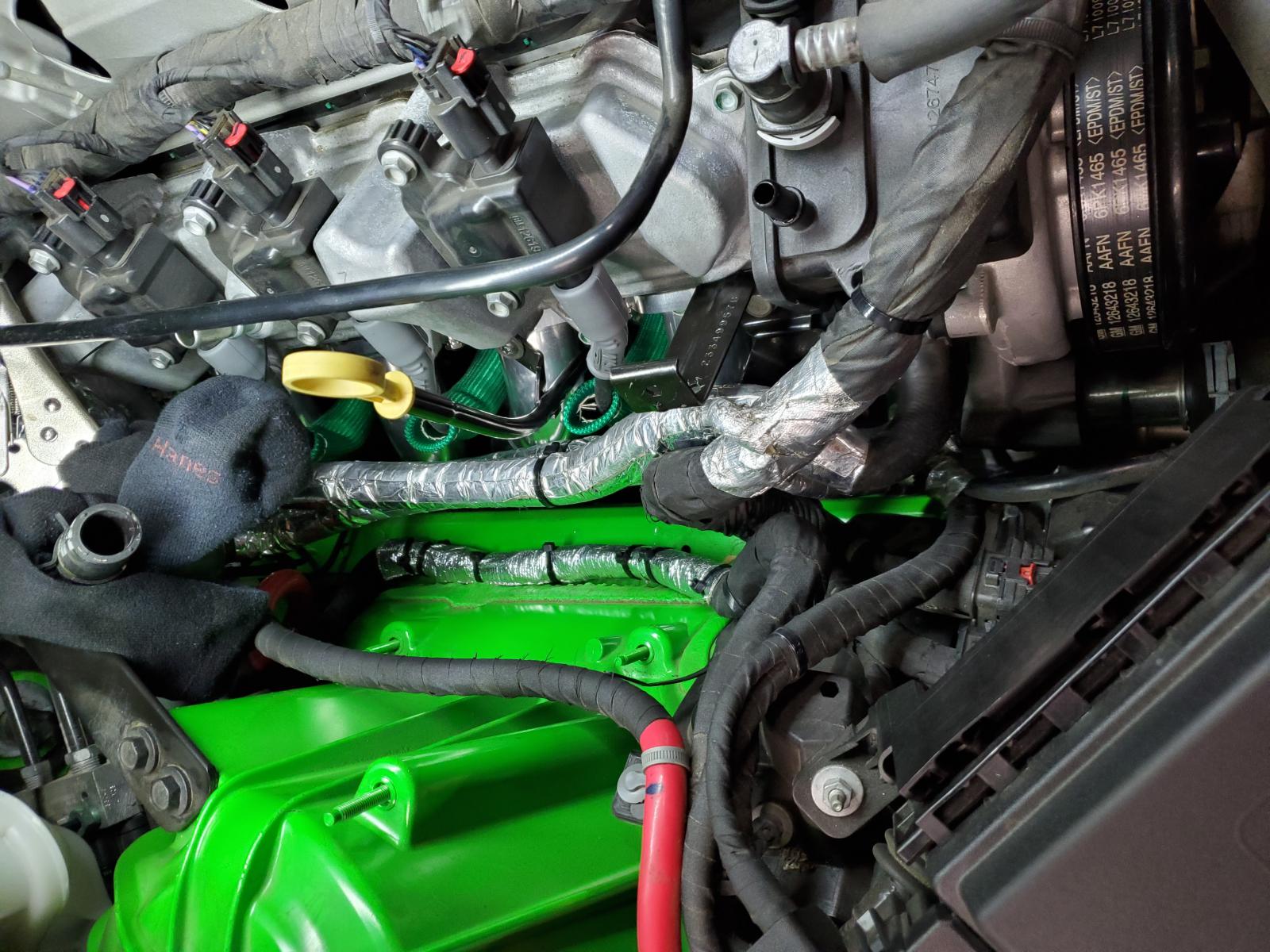

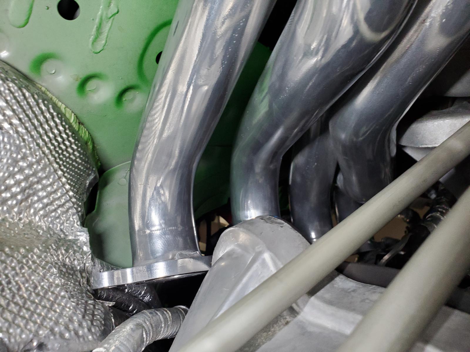

I got under my car today to replace my sensors and got to see the exhaust shops work. It's a little boogered up, but he didnt take much of my coating off, so I'm happy about that. Seems like so many sensors now lol. 3 on the driverside and two on the passenger side. I'm hoping it will help dial in the tune better at least. Last pic showes the bracket to remove to allow more movement in those lines. Definitely helps with putting the starter back in. I hope you guys are making good progress on yours! Theres a winter storm here today so I cant data log, hopefully tomorrow though. All three sensors are reading on hp tuners now as well, so hopefully no more hiccups. Wait, is there and echo in here? Lol
