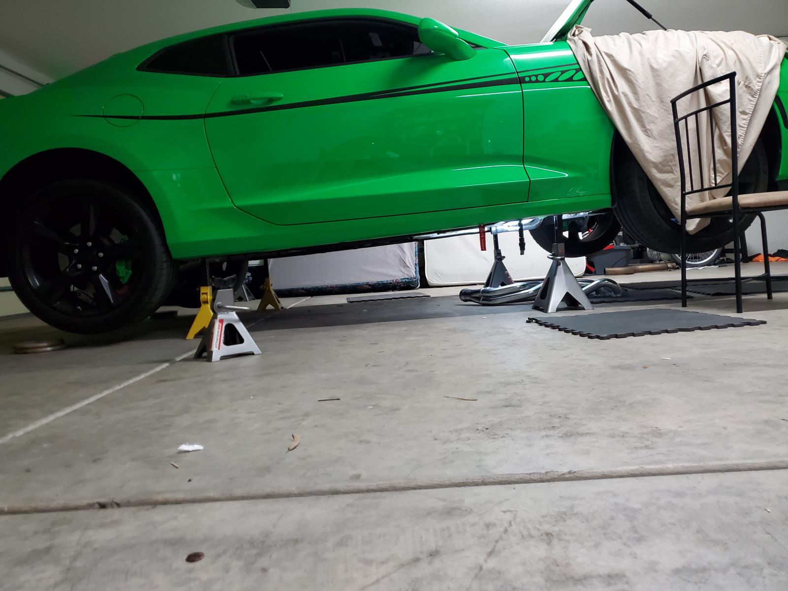

Hey guys, I'm on day two of my header install and I cant get the passenger header in. I removed the heat shield, but I still cant get it in. Kooks instructions says to remove the starter, but in all the videos I watch no one does. Am I missing something? I also cant find any videos on how to remove the starter. It's a pain raising and lowering the car so much in jack stands, so trying not to keep doing that.

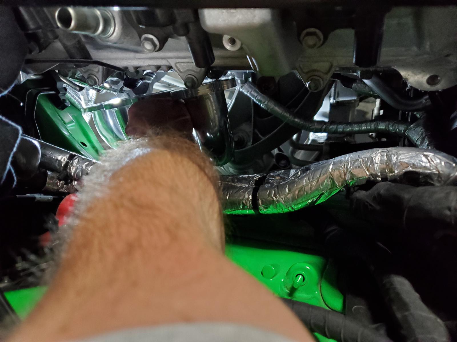

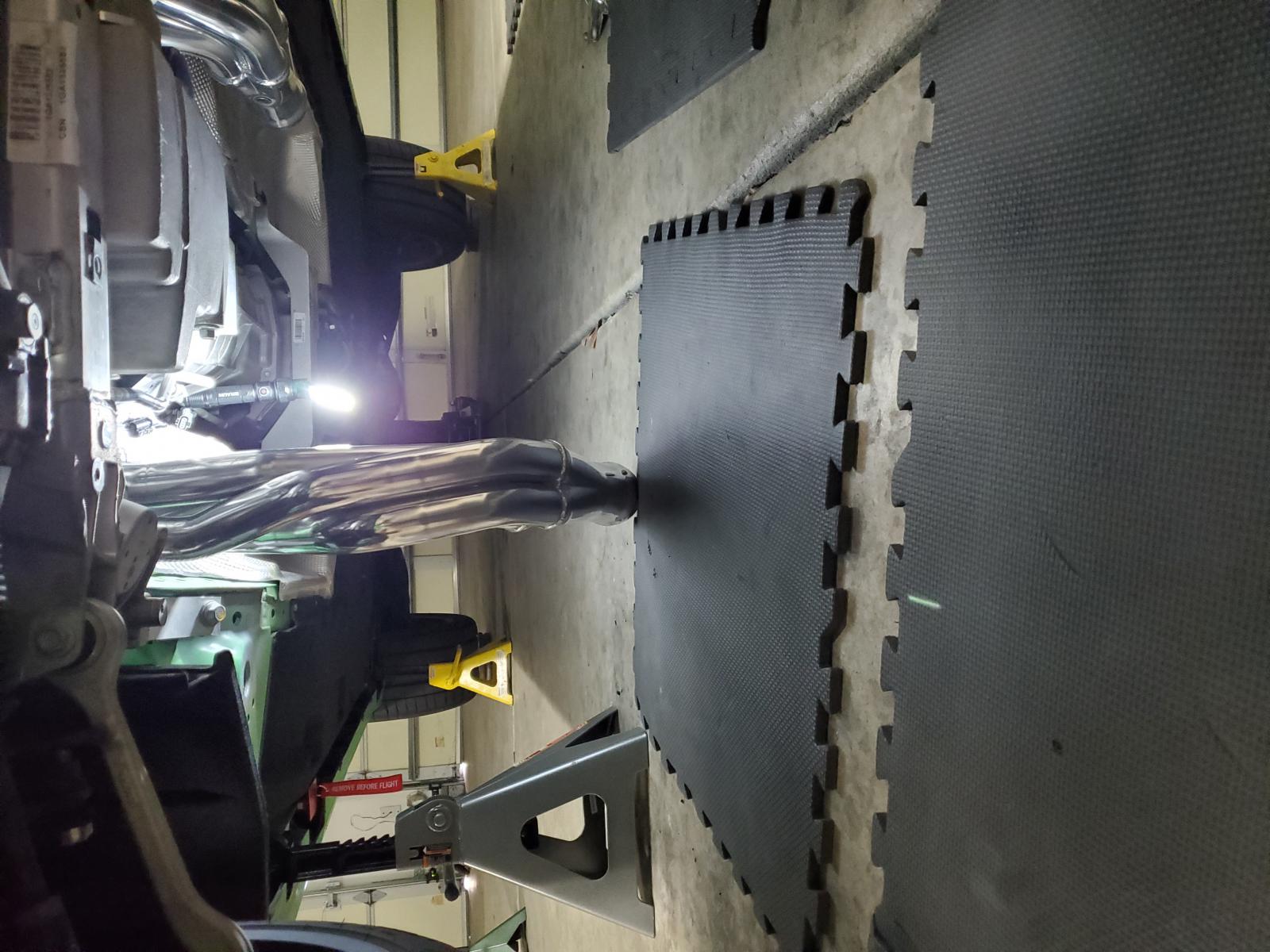

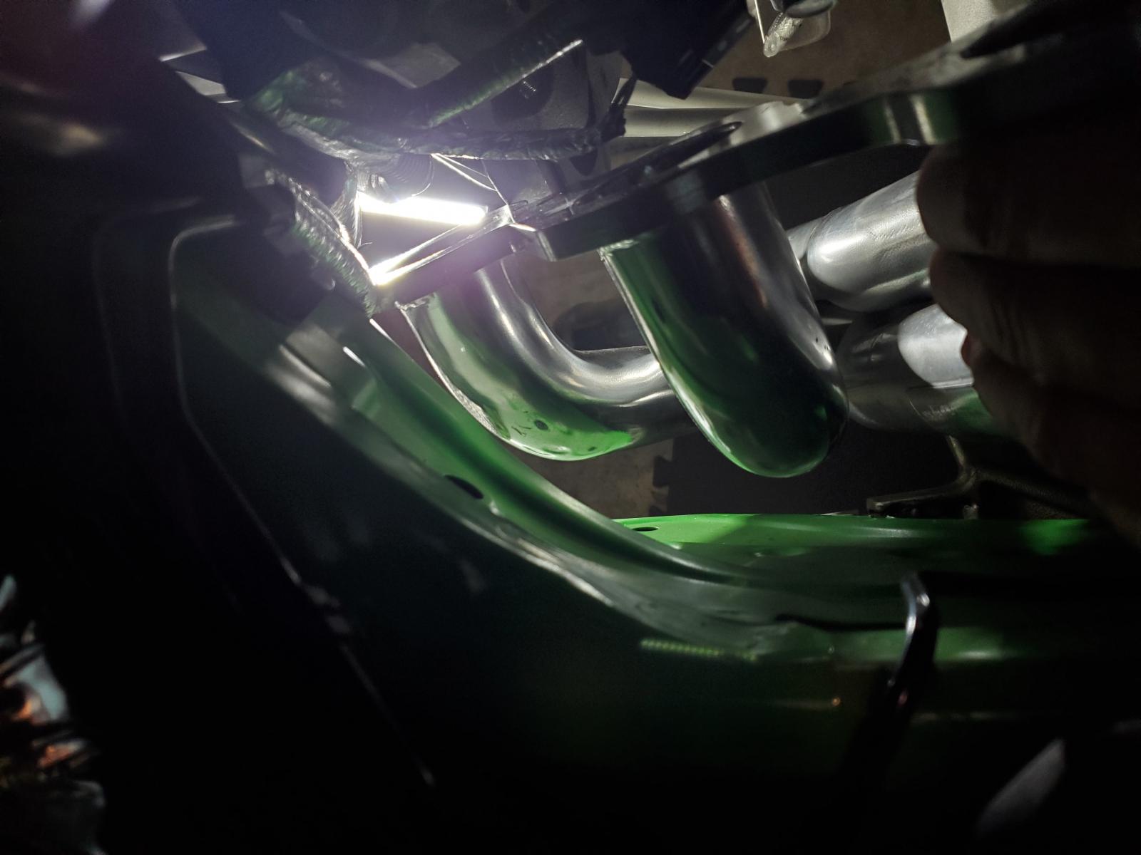

I was gonna lower it to get access to the engine, the car is up there. Anyways, I got the starter completely off, and this header just wont fit. I've been trying for over 2 hours now. It hits on the back firewall where there are some metal black lines covered in heat tape. Bottom of the car is at 19", and I wont go any higher as I feel I'm on the edge of having safe working environment. I'm working solo, and have no one to call for help. Honestly, about to quit and try to hire a mobile mechanic, this job is way way more complex than my older frs, and a bit frustrated atm.

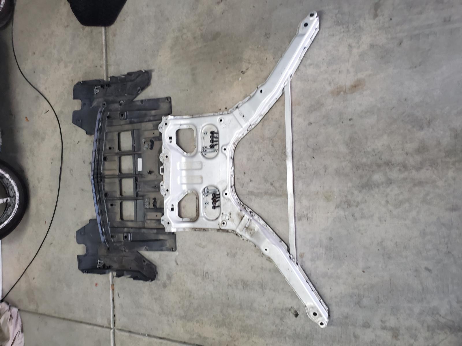

I guess injust needed to complain about it more lol, I went in for one last attempt and wiggled it in, SUCESS, omg, if I had that much trouble, how hard is this dipstick gonna be hah 5 1/2 hours to pull everything apart, 3 hours to place the headers in the right spot. Definitely not a small job

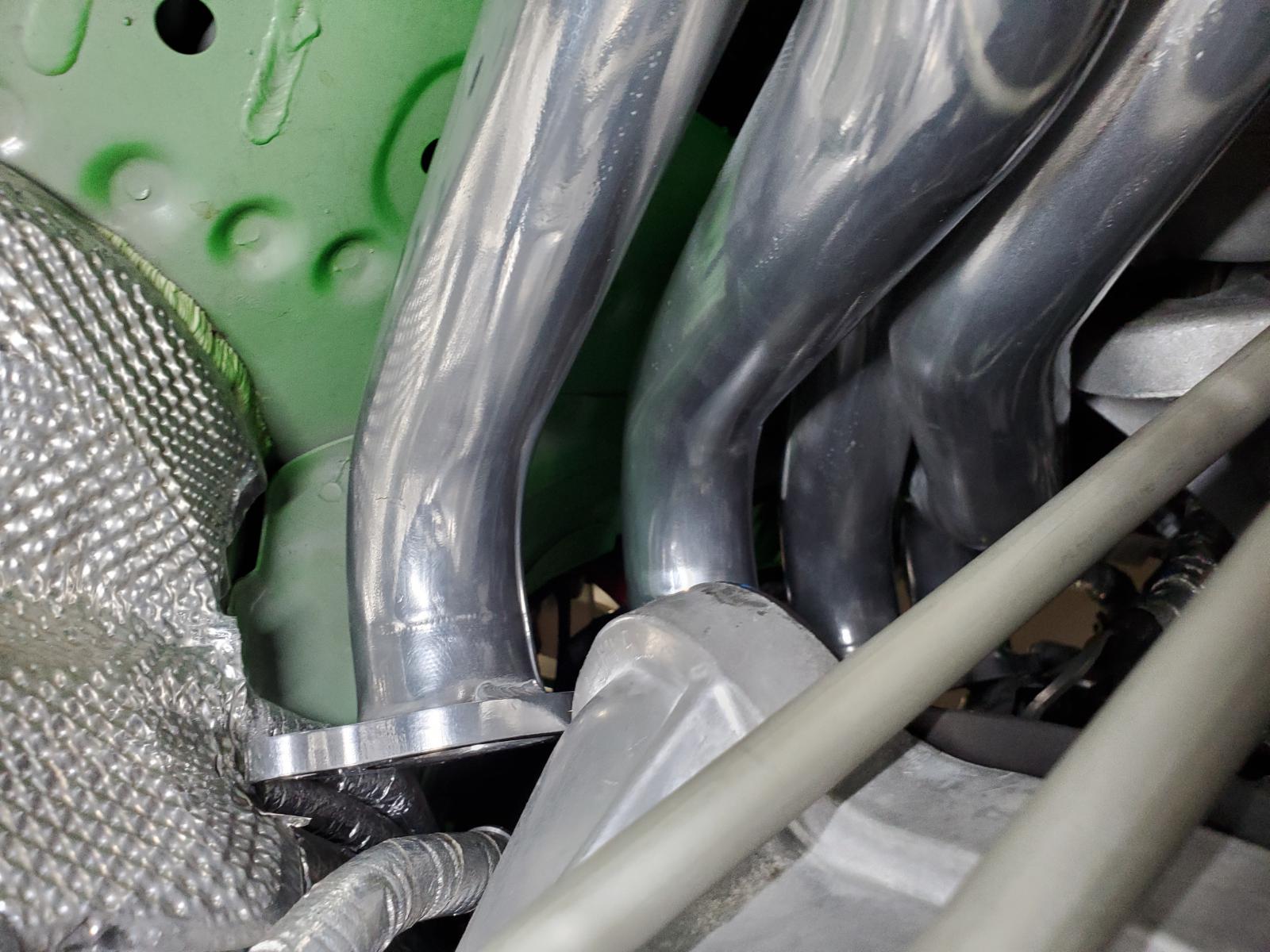

Perfect thankyou so much guys! After scrambling around and buying a bolt, when I was putting the cats on, I kept hearing a rattle when I was tapping it for well rattling lol. And upon further inspection, I found the bolt! It slid down the headers like a slide right into the space between the 4 tubes and the merge spike, hah. I appreciate all of the help and forgive my frustrations. I'm stopping for the night, and getting a ride for work tomorrow. Should finish up tomorrow assuming there is no leaks are cracked plugs. /fingers crossed Headers are done and plumbed in, and car is in the ground, just gotta do the plug wires and start reassembling. I left the bottom pieces off untill I verify it's all good and tight. Driver side was interesting to cut the borla secondary cat delete, that's my only concern with leaks really.

Make sure you move the wiring harness on the passenger side to behind the coolant reservoir. Heat tape and zip tie everything away from your headers. Wiggle things around a little after bolting headers up to make sure you don't hit anything (your motor moves some on the mounts) - this will avoid rattles in the future. Spend some time making sure the steering shaft doesn't hit the header on your driver's side. You need a good bit of clearance on this because, again, the motor moves a bit while driving.
May be too late, but tighten header bolts from inside out. I went hand tight first, 15 ft-lbs on the first pass, 22 ft-lbs on second pass. Do your best here, its tough to get a toque wrench on some of those. It's generally good to recheck tightness after a few heat cycles. Also, the exhaust gaskets are directional. Don't get it backwards.
I've had issues with the ball clamps on the back end of the header (to the connection pipes). Make 100% sure these are straight and even. Again, recheck tightness after a few heat cycles.
