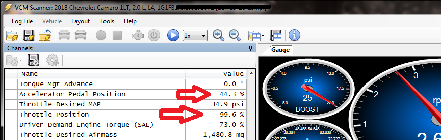

heres a shot of pretty standard tps pids for reference:
