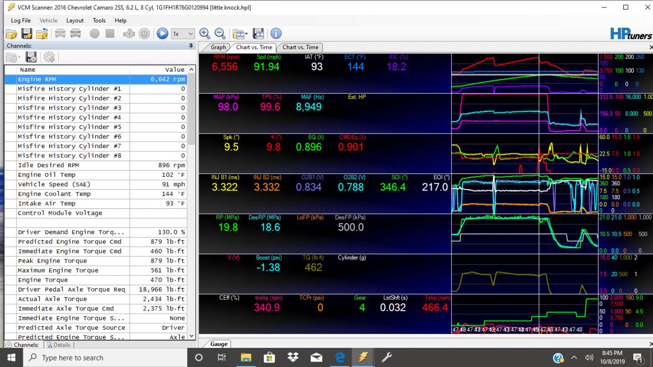

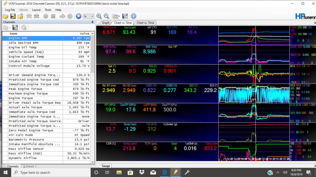

Here are two screenshots of the knock when it happens.

Just wanted to update this thread, I swapped back to stock rockers with smith brothers trunnion (btr's che's) and the knock is completely gone on a pull all the way to 140.
