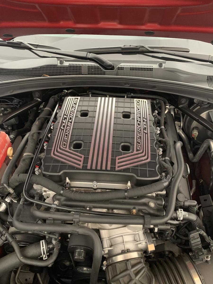

I originally ordered the non-nitrous lid on Ebay not knowing the difference, but I was shipped the nitrous-water/meth lid by accident. I noticed I had the 2 extra ports in the rear and no plugs for them. I called NX and they shipped the 2 plugs free of charge and no questions asked. Really nice people over there.
For me, the windows down sound is the same, but you can feel improved throttle response and a little extra power. With the windows up, the supercharger whine is comparable to a hellcat. It sounds amazing under partial load and even better under WOT.

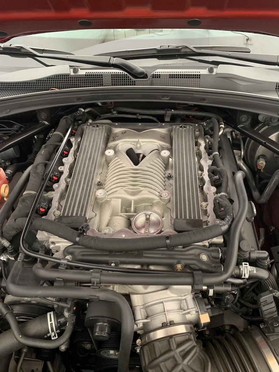

After you have removed all 20 bolts, carefully lift the lid off of the supercharger. Be careful to not break anything and there will be some lines in the way as you lift. You can easily maneuver around them.
Step 4:
Install the plugs on all the ports if you do not plan on running any nitrous or water/meth. Use the provided plugs and lock tite. Install a new gasket set on the new lid.

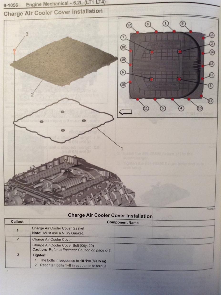

Place the lid over the supercharger cover. Place all the bolts with the black guides from the OEM lid in their respective locations. You will need to use the bolt or a punch to push the guides through.
Step 6:
Hand tighten the bolts following the pattern provided. Once you have them all hand tightened, torque to spec following the guide pattern.

Make sure you go back and retorque, in sequence to 89"lbs. Mine took twice retorqueing before they stopped loosening.

Did it today...fits great. Definitely more supercharger whine. Performance... can't tell. Weight...nearly identical to stock. The OP needed a stock lid underside pic for a comparison. 3/16" Allen wrench required for the 8 plugs.
