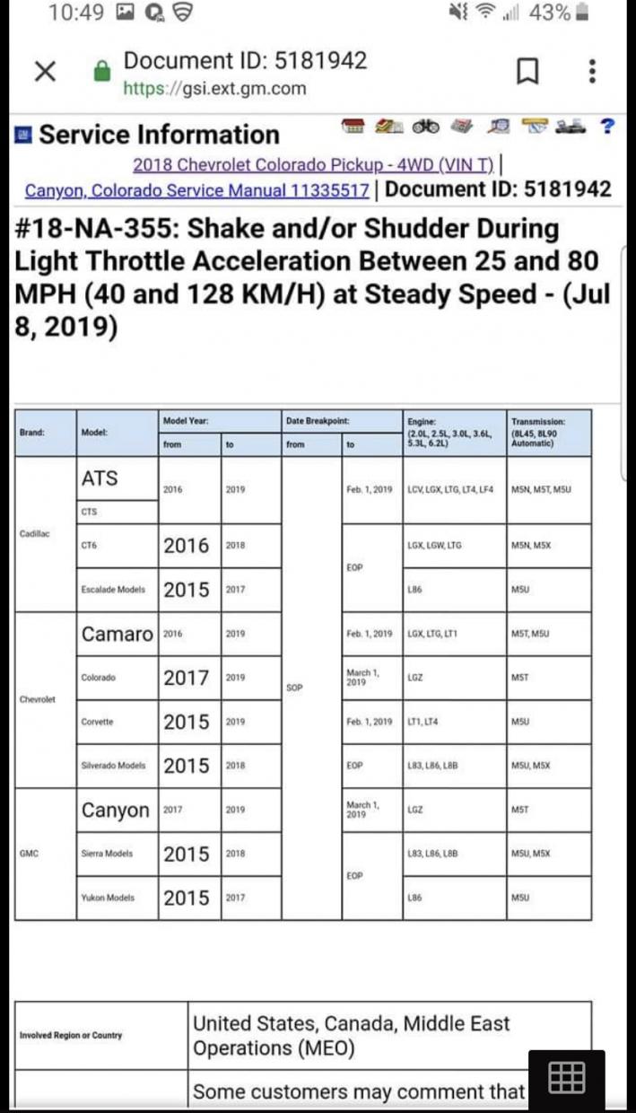

Anyone have a copy or link to the most recent shudder TSB? Looks like no diagnosis required if built before March 2019 based on the July update. Only customer complaint needed for dealers to perform the flush. I think I may have the start of the symptoms and would like to have documentation in case I run into a debate with the service department.
I pulled this off the Colorado forum but haven’t been able to get a complete copy.

I know you got this from the Colorado forums but under the correction, it said “Diagnosis beyond the customer complaint is not required if vehicle was built prior to production dates indicated above” Do you know what the production date(s) would fall under?
See below...as indicated, I would like to confirm with a full copy of the update if anyone has it.
Attachment 998760
I’ll do some digging to confirm! Appreciate you posting the production year sheet
Attachment 998760
Did we ever find out more about this? Was it Colorado specific, or would camaros built after the 3/19 date have the same new fluid?

Took mine in a couple of months ago as I could feel the start of what I felt was the shudder, tech couldn't replicate the issue so no repair done. After seeing this TSB on here, I called the dealership, brought the car in and showed the service writer the TSB from this discussion, service manager agreed and they did the flush on Aug 13, car shifts smoother, no shudder and hopefully no more issues.
I'm pretty happy with my local dealer, even though I didn't buy the Camaro from them (bought when I was posted away in the RCAF), they've been great with me. My wife's next car may come from them.
Thanks OP for the information on the TSB, saved me a lot of grief as I wanted to take the car on a very long trip but hesitated to because of this pending issue.

Originally Posted by Hyper16 View Post
Anyone find it?
Yes! Link, screenshot and attachment.
https://static.nhtsa.gov/odi/tsbs/20...63890-9999.pdf
