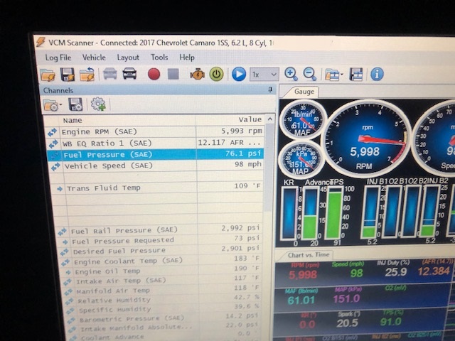

Got mine installed last night... thanks to your video Rob, also thanks to previous old posts from TMS and Tjay74... all very informative... got my JMS working correctly on my first try and now my low side is constantly over 70psi.. what a thing of beauty... I even saw 80psi at one point.
this is only a 3rd gear pull... I'll run a 1-4 gear later this afternoon if the rain goes away.... Pretty glad I went with the JMS, I thought my pump was failing.
Now @ 5998rpm
AFR 12.1-12.3
low side 76psi
rail 2900psi
inj 5.4 ms
E64 fuel stock LT4 fuel system @ 7.8PSI... It's looking like I can actually pulley down to 10psi... but im already at 619rw... dont know if i should push it more car is running so good.
So for future people reading this post... the JMS is definitely worth it.
