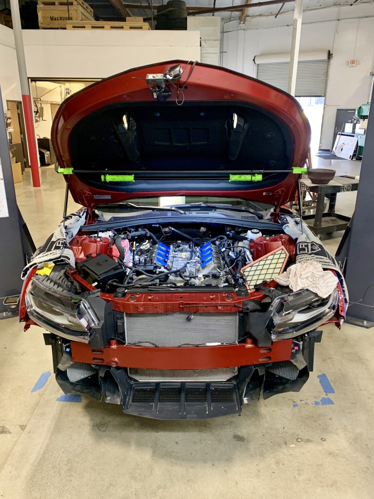

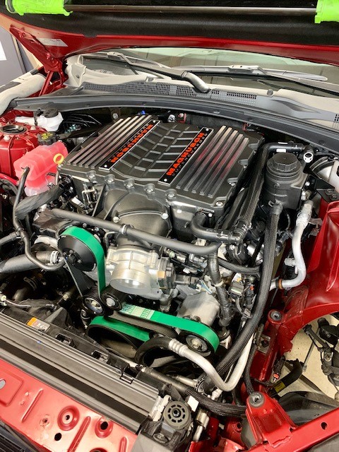

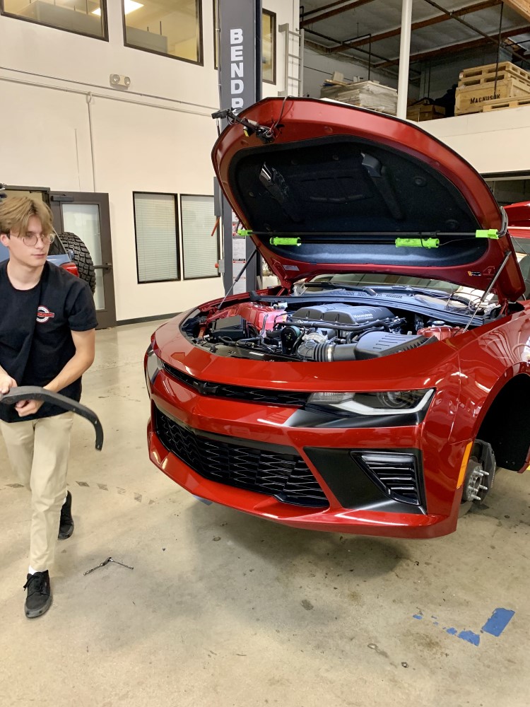

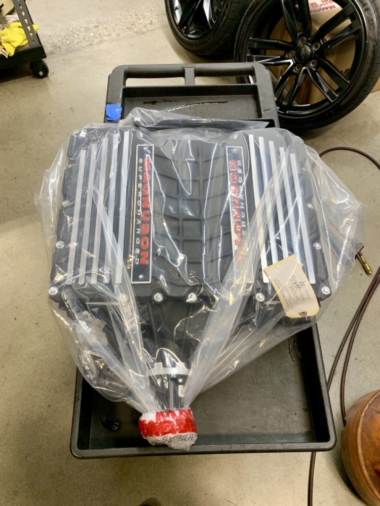

And so it begins, helping my son swap the non intercooled TVS2300 on his 2018 Camaro SS for a Magnum DI TVS2650...
Name:  Photo Jul 01, 10 48 25 AM.jpg
Name:  Photo Jul 01, 4 26 20 PM.jpg
Name:  Photo Jul 01, 4 25 48 PM.jpg
With a bit of luck it will be running again by the holiday!

Name:  Camaro 2650-01.jpg
Where we ended up yesterday - bolted down and almost ready to run, just need to finish the intercooler water system today.
