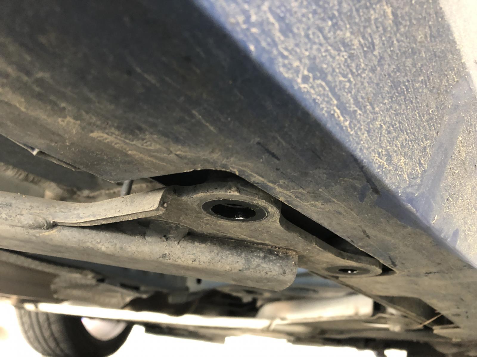

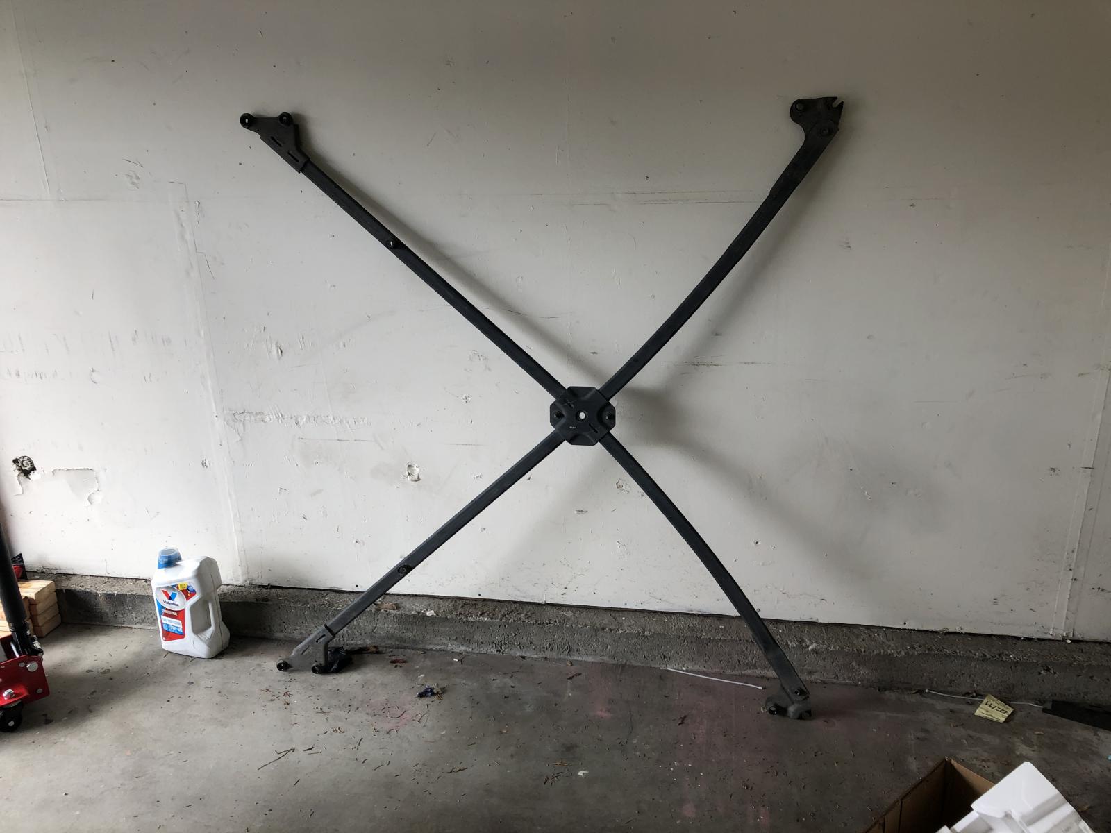

Bought a used 2017 Camaro SS, and the previous owner seems to have installed a chassis brace on the underbody. The chassis brace is fastened to the chassis using the jack points at the front of the chassis. I have attached some pictures--one of the brace's attachment points pictured under the vehicle, and one of the brace itself that I removed while servicing some parts on the underbody.
I mainly want to figure out if I need to remove the brace every time I need to jack up the car, i.e. changing a flat, etc. Do you think the brace's are "structural" enough that I could just put the jack right on the connection point?
I understand that the question might be better posed to the manufacturer of the part--unfortunately, I cannot find the manufacturer online. The brace does not seem to have manufacturer's information or part #. Does anyone happen to recognize this brace and would know the part #, so that I could look up whether or not it can be jacked?

That's the factory brace that GM installs for convertibles.

If it's bolted to a lift support point, then yes you can lift it on that point. The metal gauge is thick enough that it won't hurt it.

There are two sets of pinch welds near the front wheels. The brace covers one. Use the other to jack the car. Then put your jack stand under the brace at the point where it bolts to the body.

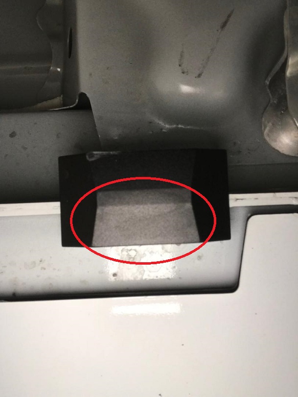

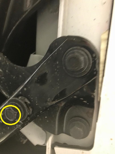

2. Equipment Locations: I started with the front and used the Cross Brace attachment bolts shown in the photographs as the points to locate the floor jack saddles. For the front, I used the outer bolt (circled in red) and for the rear I used the inner bolt (circled in yellow). The Torin jack stands have a saddle that fits the ZL-1 Lift Pads perfectly and the base on them is small enough that interference between the floor jack and stand is eliminated. In my method, a wider based jack stand would not have worked due to interference problems.
3. Jacking Procedure: Since I wanted to avoid twisting the body, I centered the jacks on the cross brace bolt (circled in red) in the front and gradually raised the car by going from side to side in small increments until I got to the height I wanted. After making sure the front was secure, I used the inner cross brace bolt (circled in yellow) to raise the rear using the same side to side method.
