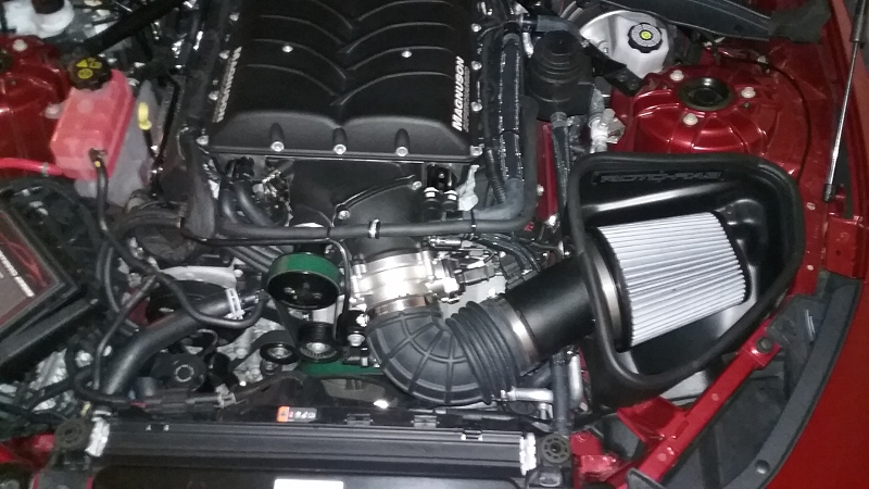

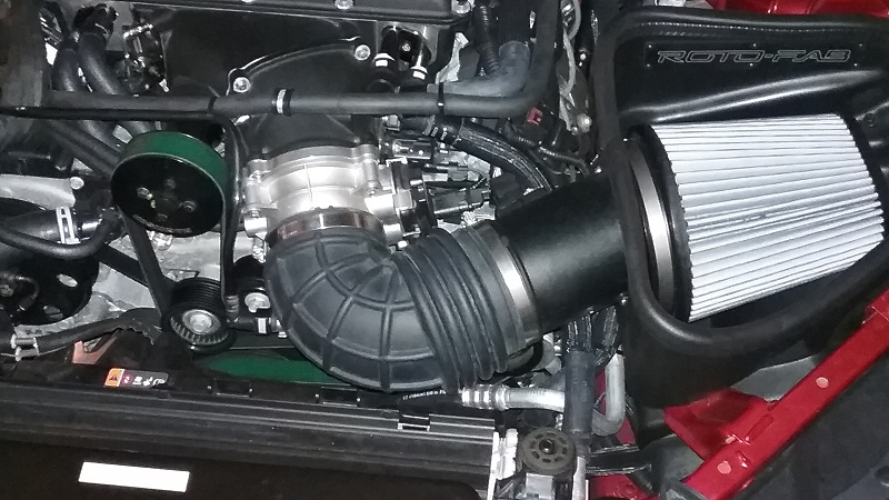

I noticed you have a rotofab CAI, I bought my car used and it came with a rotofab so will it fit the Maggie? Sorry if that is a dumb question but when I look at pictures of the aftermarket intakes that are on superchargers the tube from the TB to the filter housing looks shorter.
Not a dumb question at all. It fits fine, see Magnuson's website for photos of the intake tube hookup. I'll take a pic for you tonight. I have the original design Roto-Fab for the SS with the new 2019 dry filter element, not the ZL1 or the new big gulp model.
EDIT: added pictures (to those with eagle eyes, I've cleaned the intake filter element and yeah, I'll check and top up the coolant in the lower chamber).
