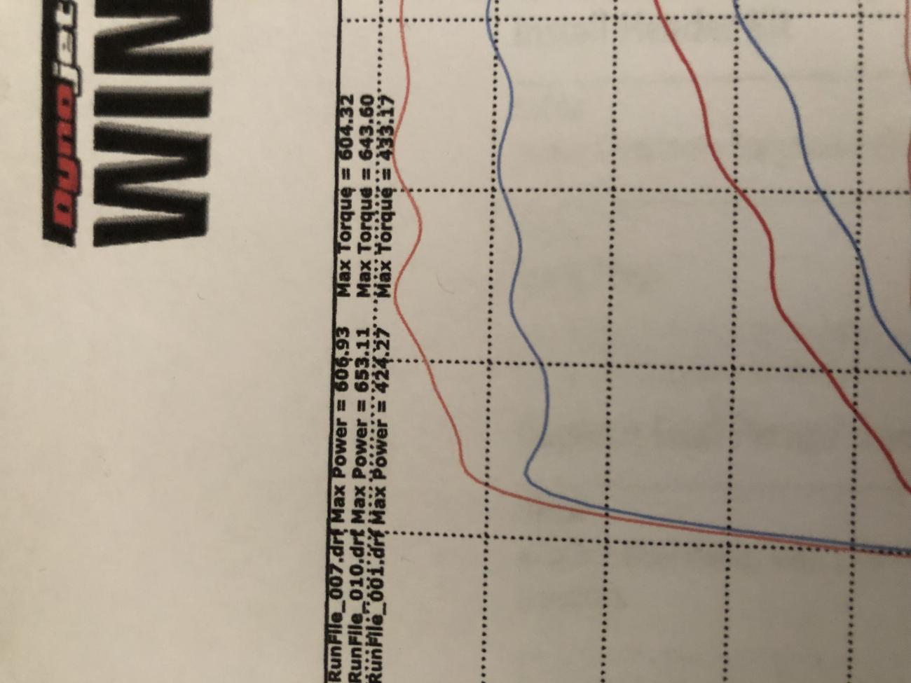

I took it to a Highly recommended shop and tuner 2 weeks ago and got the call today that everything was completed and ready to tune. Told the tuner to keep it extremely conservative and don’t want to use the meth to supplement fueling too much but more so as a safety net. Well the 1LE impressed us with the numbers she put down on 75-78% E content!
Stock baseline pull: 424/433 around 80 degrees outside
It was HOT outside today with a temp of 94 degrees and crazy humid
Supercharged with 85mm pulley hitting exactly 9psi of boost
93 pump 606/604
E75 653/644
The car is a Rocket! Haven’t been able to open her up yet as there was traffic on the way home but it’s going to take some time to get used to this power ����

A/F at WOT is around 12.1-12.3. We could have achieved more power but it was HOT (94 degrees with a heat index of 105 and crazy humid) and I was happy with those numbers on a conservative tune and don’t want to push stock internals too far. That’s impressive numbers on the LT4 Blower. What E content and boost are you at to reach those numbers?

From my research and experience you are relying on that meth more then you are lead on to believe with that fuel system and E content. LT4 fuel system alone is normally good to 650whp or so on E50 and 620whp on E60. My guess is if you turned the meth off, the AFR would lean out into the 12.8 range. It probably wouldn't even KR with E75, so I would say you are still safe in the event that the meth didn't work and you went lean on a pull. You just wouldn't want to run that lean all the time.
I never cross compare dyno numbers. Some pull STD, some SAE, some pull 1:1 others pull in a lower gear.

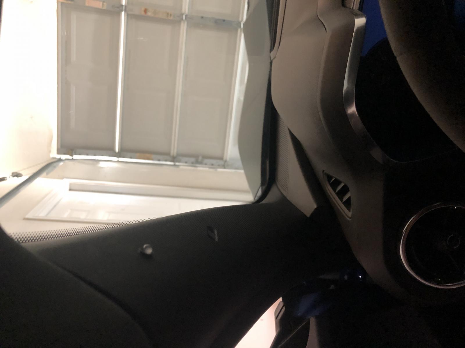

I definitely did not want to push more than 10psi of boost on the stock internals and I feel somewhat safe at 9psi and flex fuel. I want this engine to last until I can open it up and start the forging/heads process and that might not be for a long while. The shop put the Alky pump light in the pillar right at eye level so I’ll know real quick if it’s not spraying meth as soon as I go 3/4-WOT.
