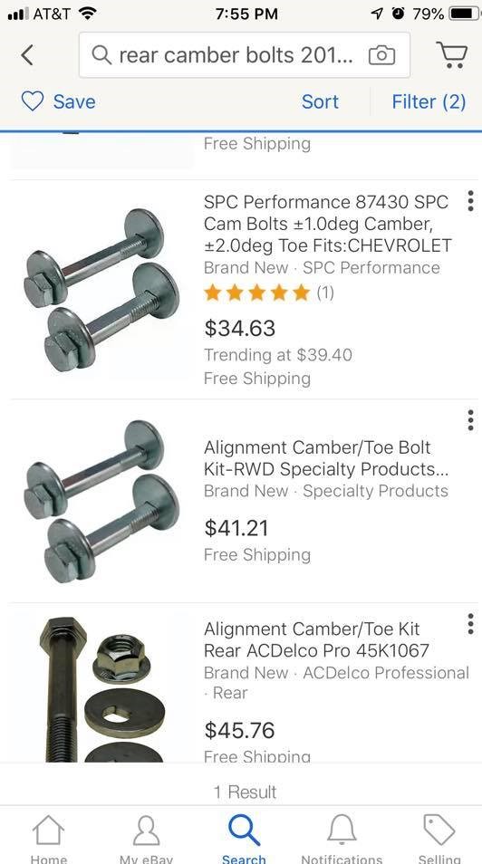

Talking with other folks, bolt #6 is needed, to replace issues.Name:  IMG_3170.jpg

The alignment shop you used should of replaced parts. This is a quote from another forum I've been chatting with " These are what they look like they are kinda like egg shaped washers ,factory one,s are built on the bolt aftermarket are not like picture as you move bolts when loosened ,the egg shape gives neg or pos camber depending left or right turn , the reason for new is any suspension bolts always requires new per OEM manufacture specs & a lot of alignment shops don’t but should"Name:  62475225_2389364704453298_2494065797727518720_n.jpg

The alignment shop you used should of replaced parts. This is a quote from another forum I've been chatting with " These are what they look like they are kinda like egg shaped washers ,factory one,s are built on the bolt aftermarket are not like picture as you move bolts when loosened ,the egg shape gives neg or pos camber depending left or right turn , the reason for new is any suspension bolts always requires new per OEM manufacture specs & a lot of alignment shops don’t but should"Attachment 991406
SPC makes good stuff. The egg shaped bolt is called a cam washer 👍🏻

i got them from my chevy dealer they were like 22$ each lol pricey ass bolts
