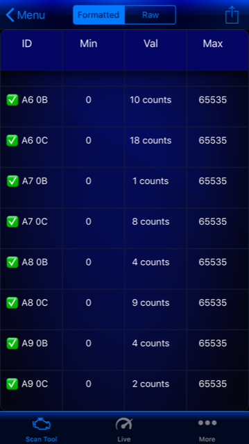

So I think I have figured out my rough/high idle when the car is cold.
I see that Cylinder 5,6, and 8 show misfire counts upon me starting the car before it warms up to temperature. After it warms up (about 1-2 minutes) car runs perfectly fine.
I have new plugs in, MSD wires, and heat sleeves on the wire.
Thinking about maybe trying to remove the heat sleeves off the wires and try to re-seat everything again.
Maybe after that, if it doesn't work and I still receive misfires will I see about checking the Fuel Injectors for those affected cylinders.
What do you guys think? Thoughts?

Swap the affected plug wires over to another cylinder and see if the misfire counts follow, if they dont you may have bad injectors.

Most likely the injectors. I had the same problem. Replaced the injectors and it's been running good.
