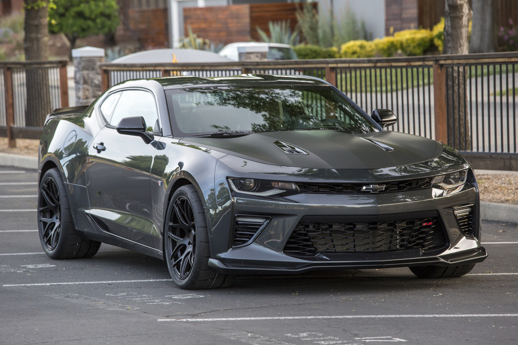

mrr wheels FS01
one of our early customers did this set up
19x10.5 and 19x11 using 305 front and back
