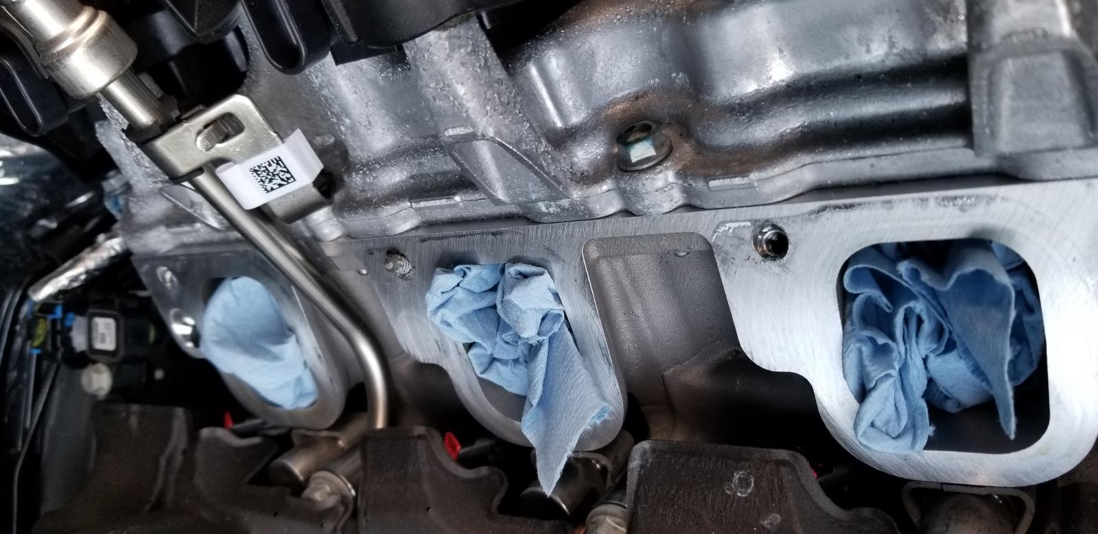

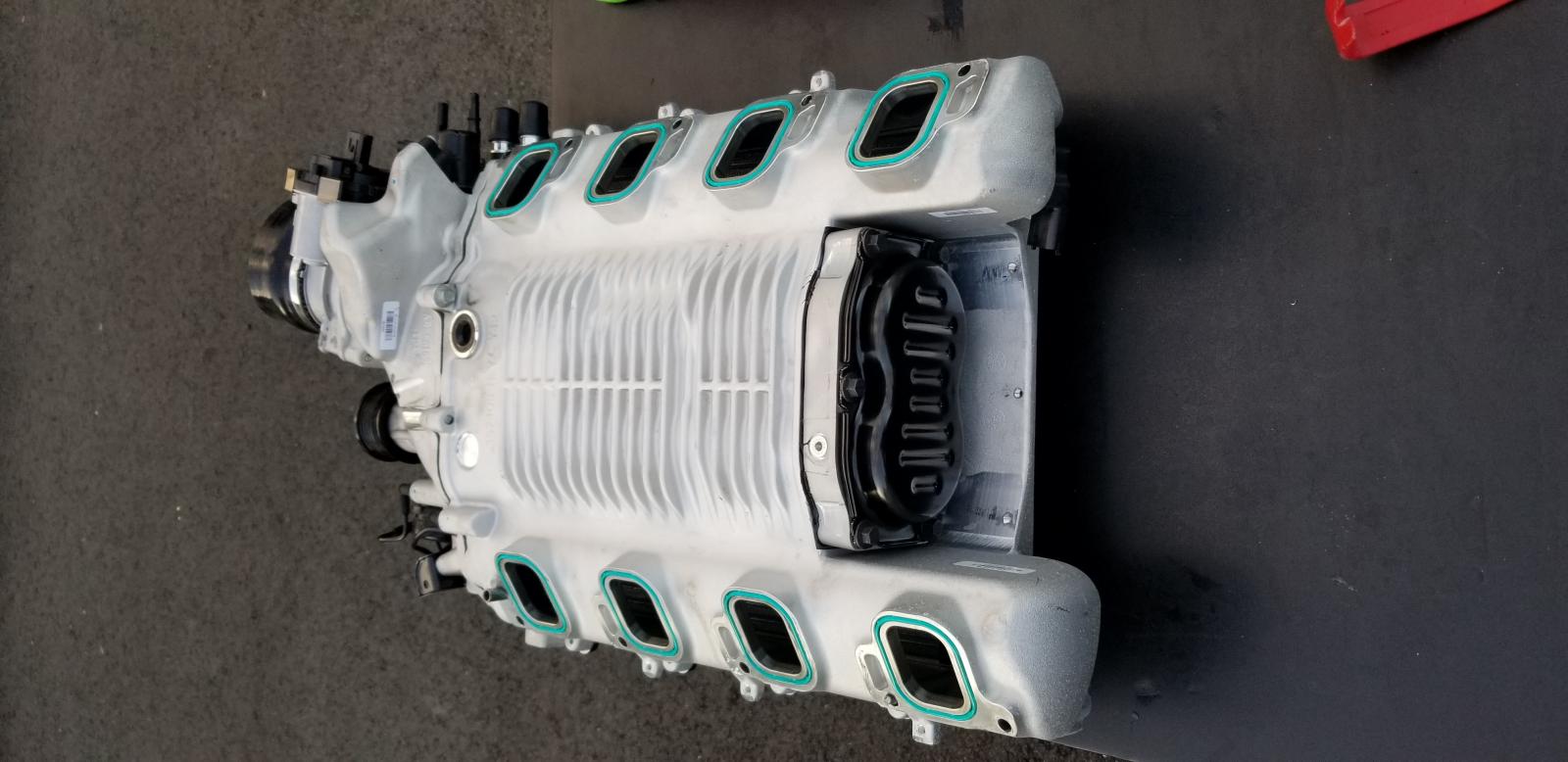

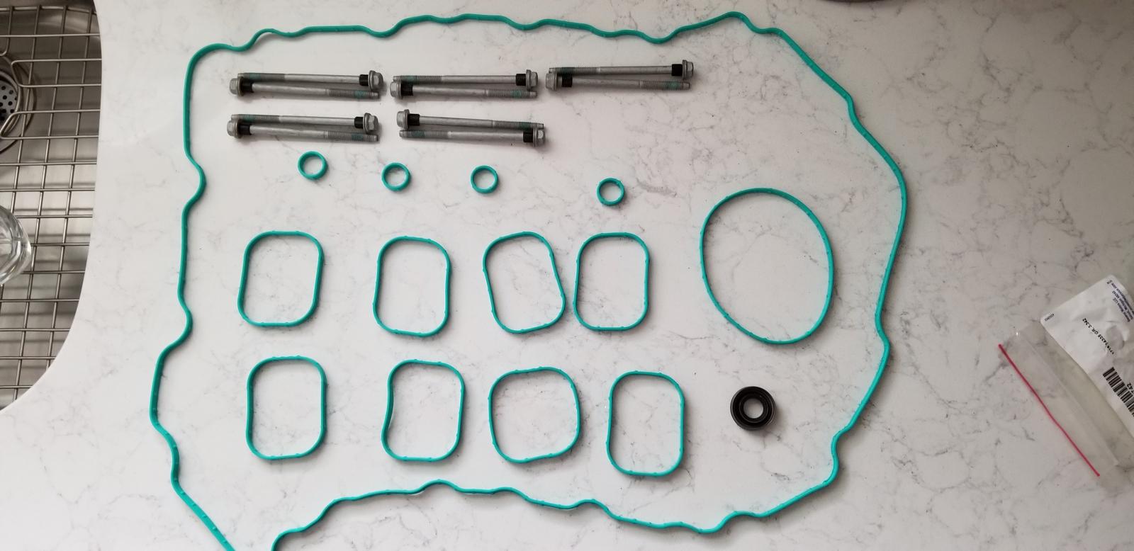

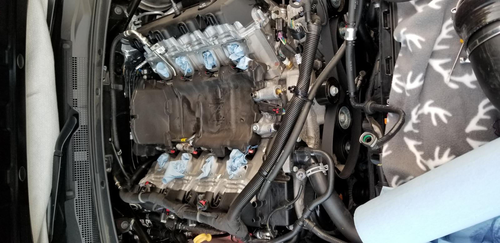

Guess who got the broken bolt out... Name:  20190524_192109.jpg
D3adch1ld is offline   Reply With Quote

Originally Posted by D3adch1ld View Post
I believe thats the same bolt that broke on me...job well done!. I didn't take the SC completely off, just lifted it up enough to get the bolt out and replace the gaskets.
