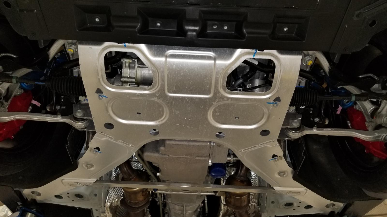

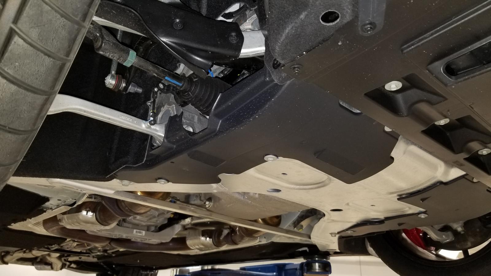

I hope that this does not sound pretentious, that is not my intention.
I would encourage all that own this machine to put your car on stands and spend some quality time on your creeper exploring the magnificent underbelly of this car. It is likely to give you a bigger chubby than the shiny side. An appreciable amount of time spent there may reveal the answers to all of your questions and concerns about aero on the underside of the ZLE.
With that said; 84669205 is new for 2019 and looks amazingly functional and beneficial. Those of us that have spent time on the creeper get it. I'm looking forward to your impressions ICTsccaCamaro. Thanks in advance.
IMHO, the center air dam (center, under the splitter) rubs WAY before the outside dams do. The outboard dams do not in any way protect the outboard curved deflectors. Keep the curved deflectors and center air dam on the parts shelf boys, they get scuffed and occasionally hit hard, even when driving conservatively. Fortunately the plastic aero sections under your splitter are readily available, relatively inexpensive and are very easy to replace.
If you drive this car (even in the highest clearance setting) you WILL scuff up the under splitter aero, no matter how much you baby her or how hard you try not to. If you are pushing the envelope, count on constant wear and tear there. Fortunately, GM did a good job of making these parts semi disposable.
Disclaimer, my Camaro has never sniffed a speedbump and my driveway is a low clearance wet dream. My under hood (extractor) water deflector is only installed in the driveway for bath time. Gotta keep that LT4 and her components cool.

How dare you suggest we take the time to understand our cars! And I agree, it's a marvel under there.
All that said though, what is your take on those outer deflector tire dams? On or off?
Would you recommend leaving 84669205 on all the time, or do you see a significant concern for water ingress if caught in some water or driving through an inadvertent puddle from sprinkler systems, etc.?

It would depend on application. As a DD, likely not because as you mention water intrusion from rain and puddles. For warm days and track, heck yea! The cooling potential from 8466205 is definitely intriguing. I'm interested in feedback from those who run it.
My outboard dams are on. They have protected my splitter from minor scraping. I'm certain that there is some high speed function/influence, or the engineers would not have designed/installed them.
In my case, the outboard dams don't protect the curved deflectors, mine have been nicked a couple of times. Center dam under the splitter has scraped a couple of times as well. Fortunately, my splitter is still clean. I am at 3/4 front ride height most of the time.

Well the 2019 steering rack ducts went on perfect.

Looking at that I'm not sure what the concern is with water ingress...even with those large shields, in heavy enough rain, turning, driving through light standing water/puddles, etc. everything up there is getting wet anyway?
I don't see a compelling reason you couldn't run those P/S coolers full time if the car is mainly a track and dry/warm weather non-DD?
Also, thanks for the great pictures!
