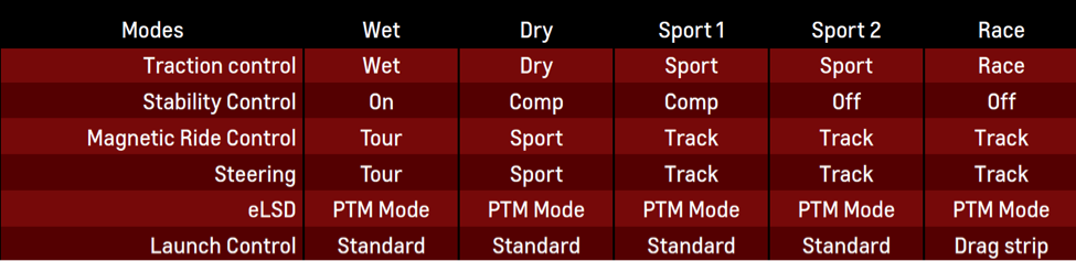

Found this, nice little visual guide
Edit - Came across this as well, very in-depth exploration https://www.camaro6.com/forums/showthread.php?t=496996

The e-diff. section is simplified in your spreadsheet.
There are 4 modes to the e-diff depending on modes.
The PTM modes allow more nimble turn-in and less lockup to get you around the corners faster. Outside of the PTM modes, the e-diff. main focus is stability.
It is for this reason that I use PTM Sport 1 for any spirited driving with turns.
