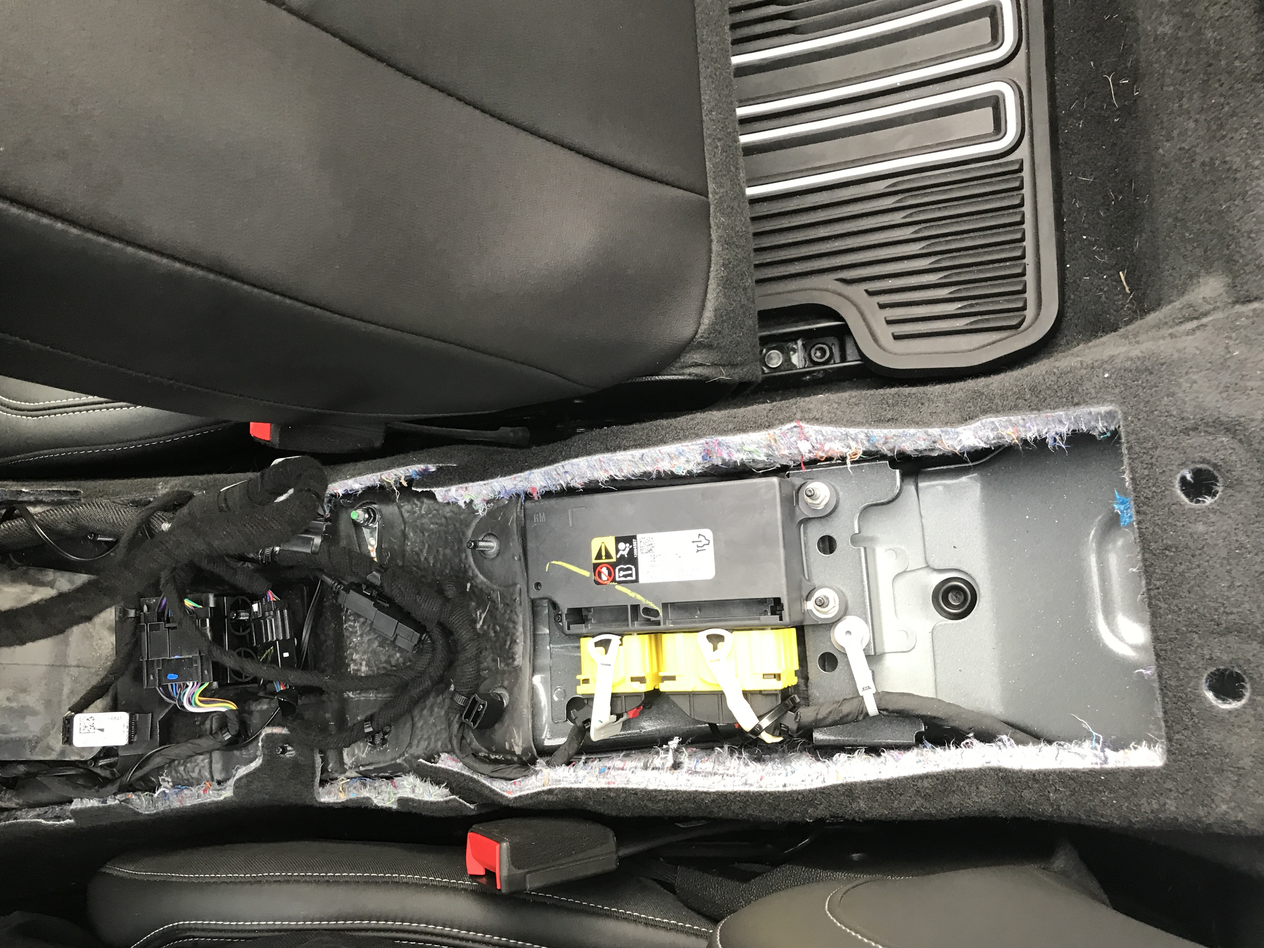

I realized that I never posted my hardwire setup for this.
Since I have the V1connection to bluetooth to my phone, AND Concealed Display, I needed the hardwire power plus accessory connection with two RJ-45 jacks plus a phone jack splitter. No way that would all go up in overhead, so wired to center console
Took off center console (6 bolts - 2 under each knee pad, and two under the round pop out covers by back seats (under wireless charger)

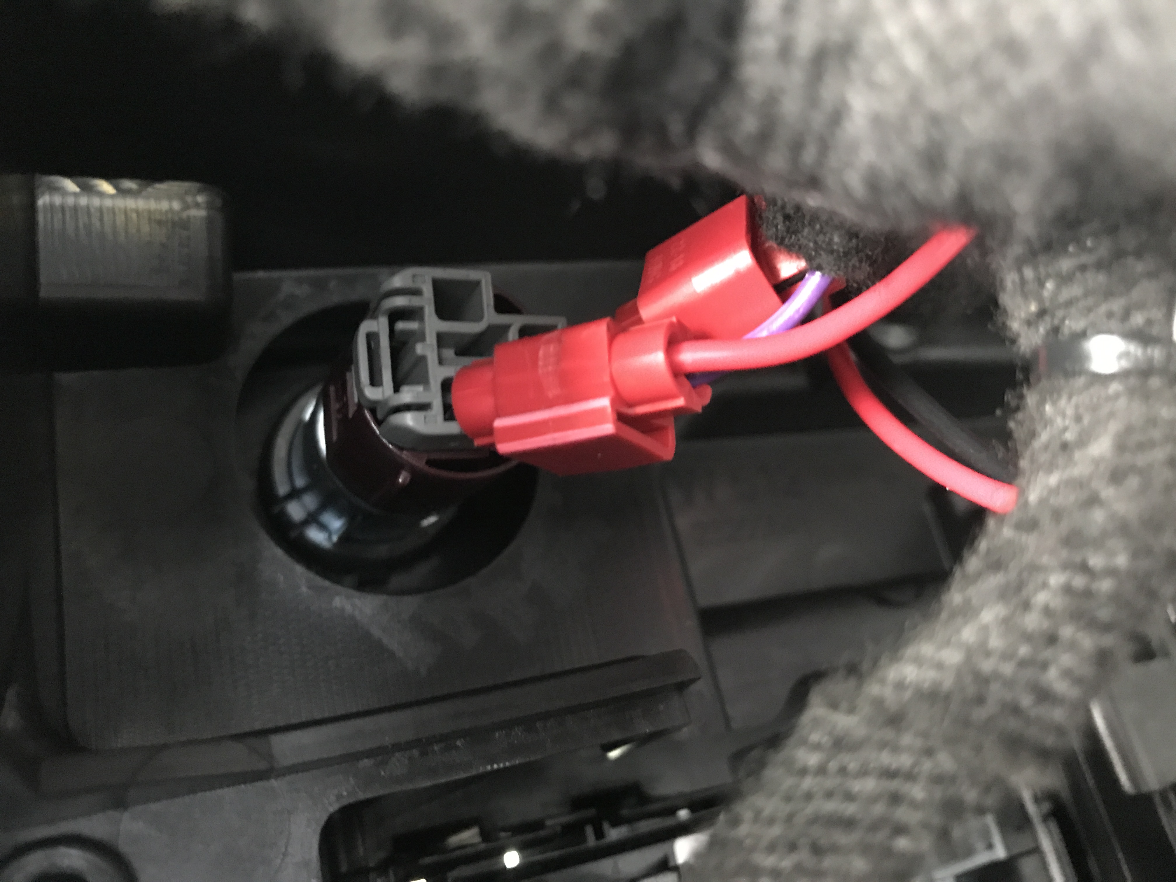

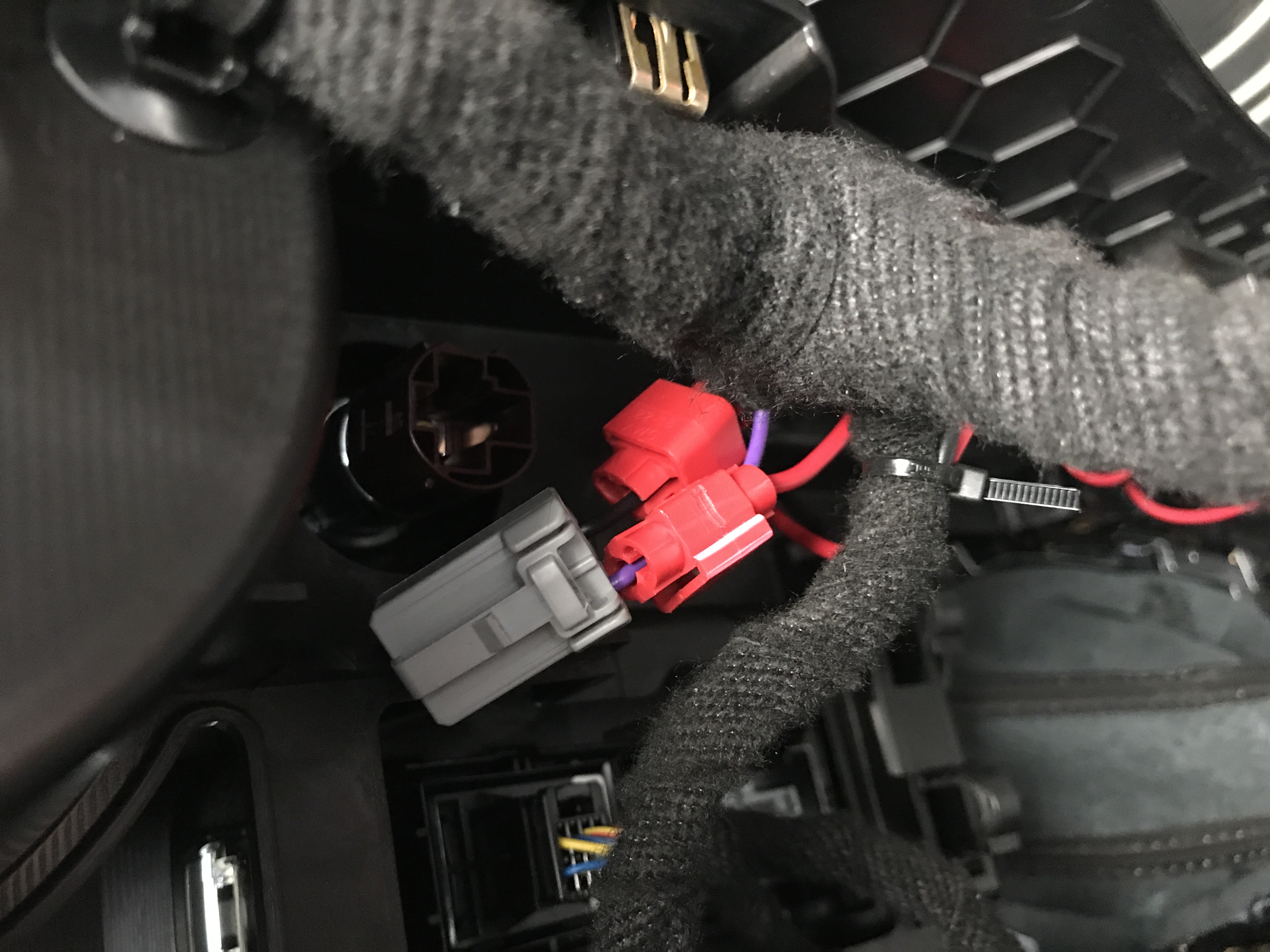

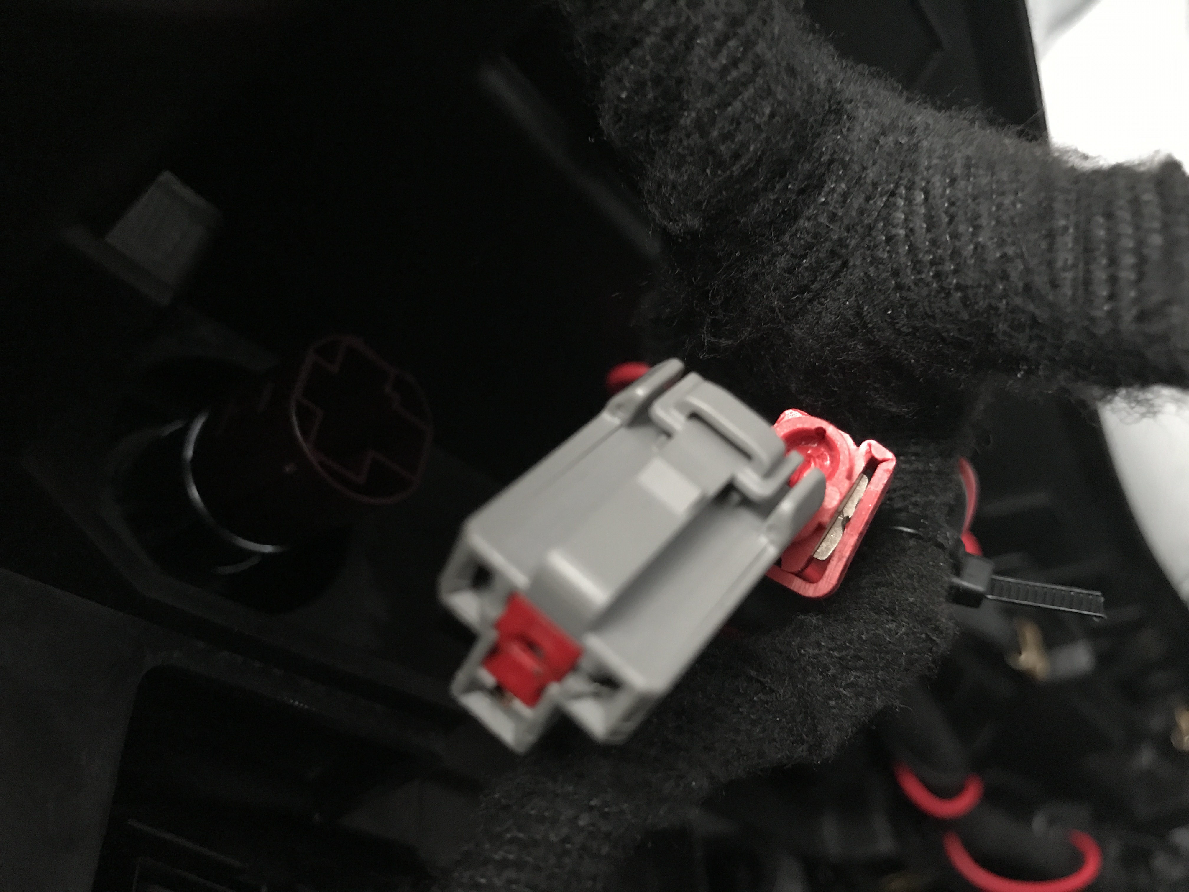

Disconnected Cigarette lighter power connector and used quick wire splices to connect wiring harness to power and ground
Bottom of console where cigarette lighter power outlet is

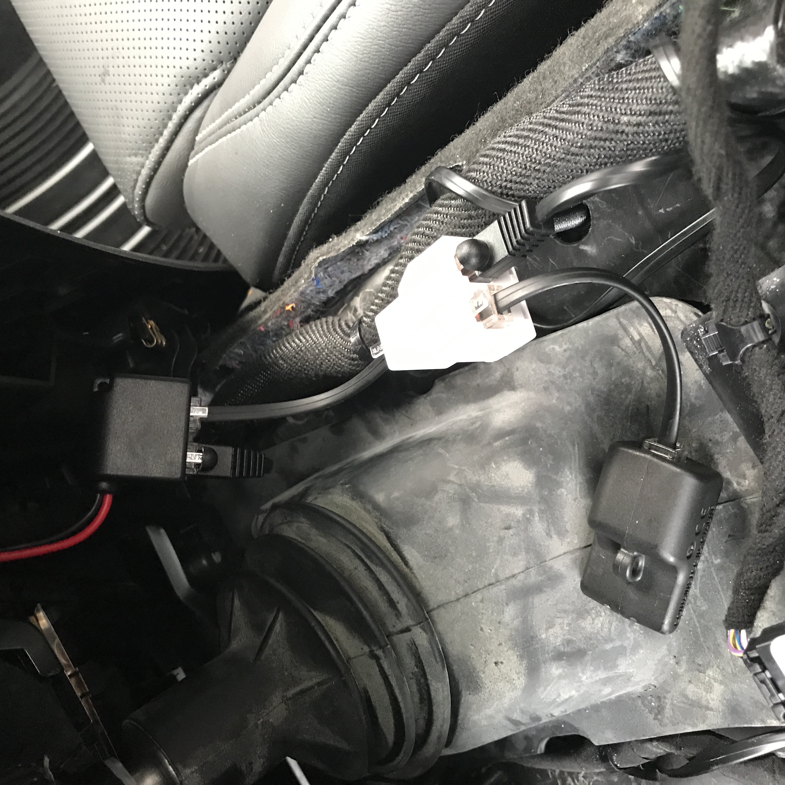

Here is the power connector, the V1 Connection bluetooth and the splitter I got
I was able to use wire ties and place each part in areas where they won't get in way or shift around.
