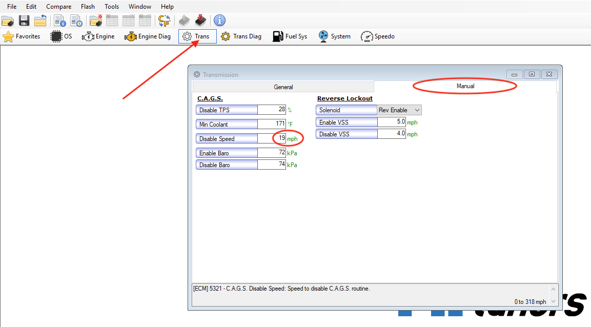

In VCM Editor go to the Trans tab. From there click on the Manual tab. Then look for the "Disable Speed" parameter and change the speed to 0. Upload tune and you're done. See pic.

cool thanks. On the HP forum i found someone with a european stock tune and in that it had everything maxed out
0
479
0
256
256
