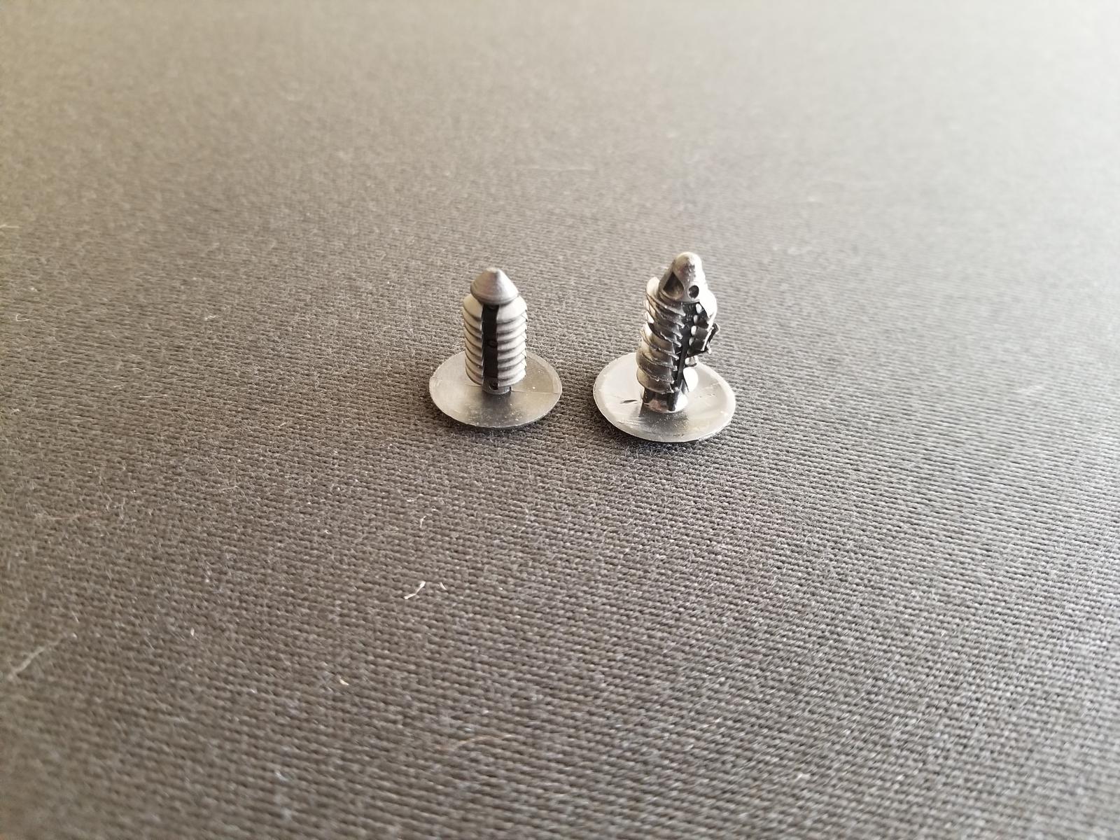

Get some of the plastic plugs that hold trim panels on. Something like these. Cheap. They fill the holes and are almost invisible. I had to enlarge the holes a bit. The shaft of the plug is slightly oval.
