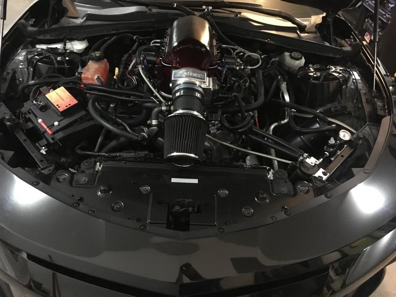

My SS is not stock but I am running Nitrous from 100-150. Planning to do at least a few 200 shoots then back to a lower number.
I retard my timing with the Lingenfelter LNC-2014 RPM Limiter Timing Retard Controller GM Gen V DI Engines LTI. I have tied in the launch controller with my line lock. So when I get in the box, I switch on the line-lock only to warm up the tires. I switch the switch to both launch mode with two step and line-lock at the line I have a stand-alone fuel system in the trunk to deliver the fuel. I use 110 octane in that system for the NOS which tuner recommended when using a larger shot. Last year I used a WOT TPS sensor, I am presently going to change it to a progressive delay box. Colder plugs, there are lots out there. I have an automatic opener which I highly recommend, I also have the auto pressure sensor for the heater which I also recommend. Purge system.
I would say prefect your 100 shot before going larger. A proper tune from a good tuner is very important.
Also, learn how to read plugs and pull them to look at them to determine how well they are working. Gap Gap Gap
LT4 1.7 Supercharger snout ported & 100% Meth
103 Katech TB, KATECH Custom Heads, DSX In-line fuel
TSP Headers, Spec P Super Twin Clutch, TSP EL C7 CAM
Diamond Piston & Manley Rods, Roto Fab Big Gulp
BTR Push Rods,LS7 Lifters, ARP, FI Chiller, Kirkey Seats
SJM Line Lock, Hurst Pistol Grip. 747/739 RWHP street tune - 821/794 RWHP track tune 101 octane.
