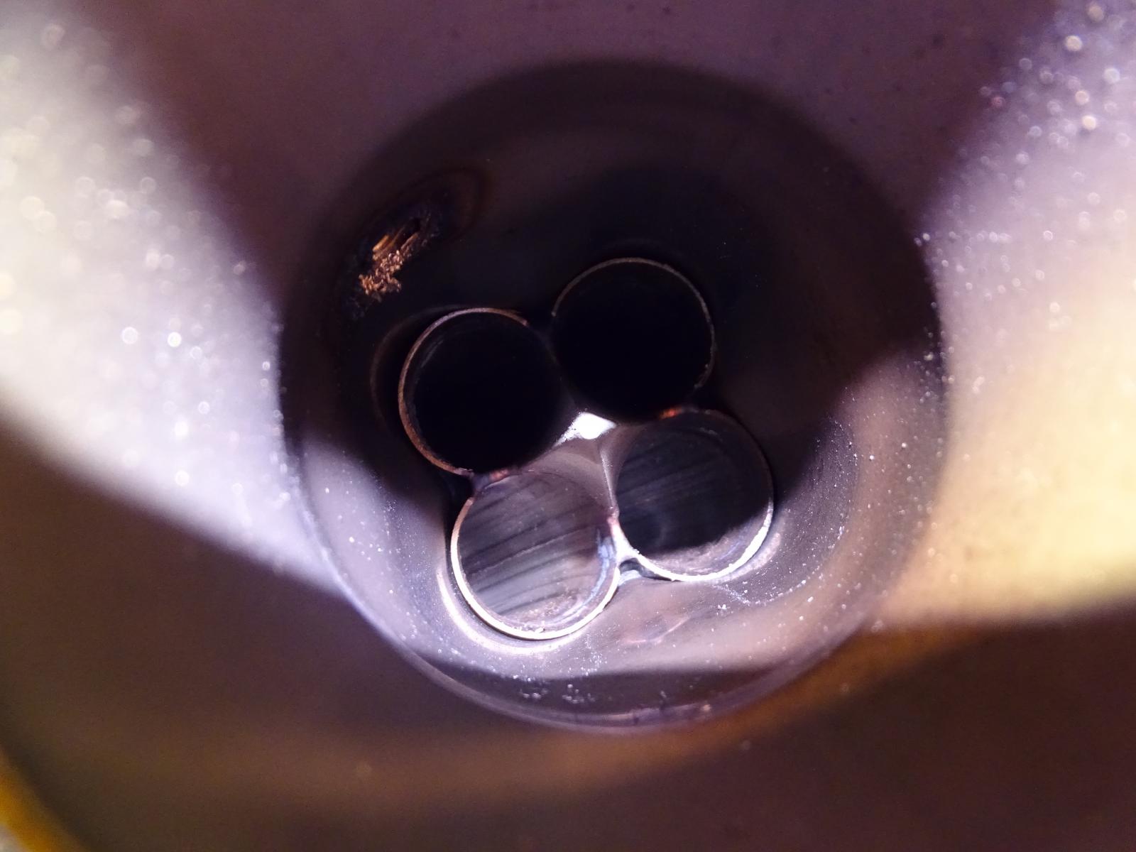

And for anyone who is curious I was able to get the Stainless Works Headers in without taking out the motor mount or starter, all I did was take out the Starter Heat Shield and had my wife help guide the Long Tubes down from the top and it fit right in place. And I was able to get the dipstick in even easier by marking where it was with a marker before pulling it out which made guiding it into place extremely easy. Took me about 20 minutes to get the passenger side in place, bolted down, and the dipstick in.

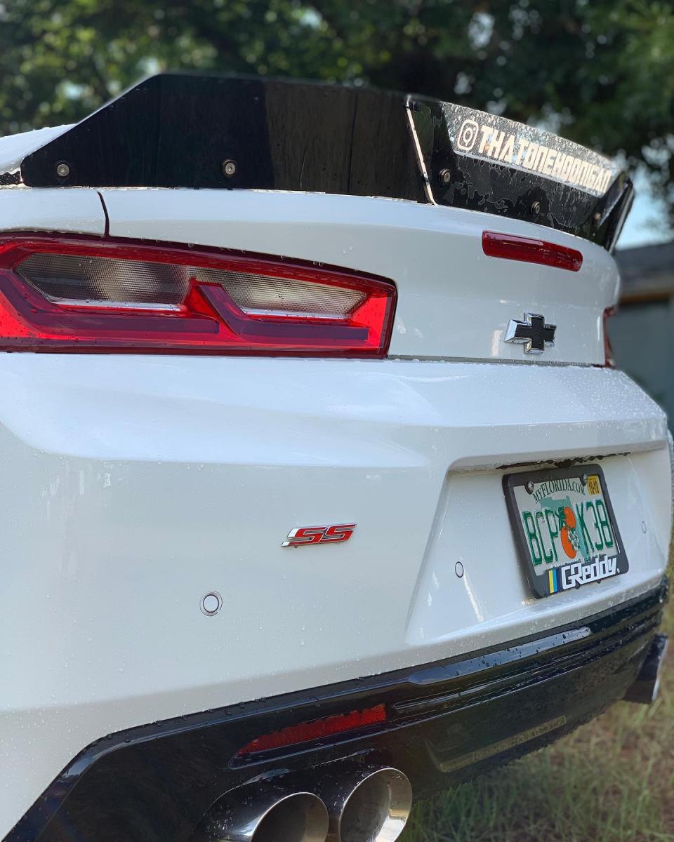

Installed a wicker bill from 3dEngineering, install went fairly well although the instructions were absolutely awful. I like the look of it and I like that it installs on the stock SS spoiler. You have to drill several holes into the stock spoiler and if you follow the instructions that are provided you'll drill holes that are too large to fit the rivet nuts, I would've drilled a hole too large had I not been paranoid about it and checking several times before I drilled any holes. My only complaint is that when you wash the car water will seep into the small crack between the 2 separate pieces and if you don't use a good spot free rinse, blow out every drop with an air compressor, or take apart the separate pieces you will get water spots that really take away from the look.
thatonehoonigan is offline   Reply With Quote
Old 06-27-2019, 03:31 PM   #8
thatonehoonigan
thatonehoonigan's Avatar
Drives: 2016 Summit White Camaro 2SS M6
Posts: 8
Couple more pictures of the 3DE Wicker Bill, the laser etching is really nice, you can also really see they water spots in the crack between the clear and black pieces.
